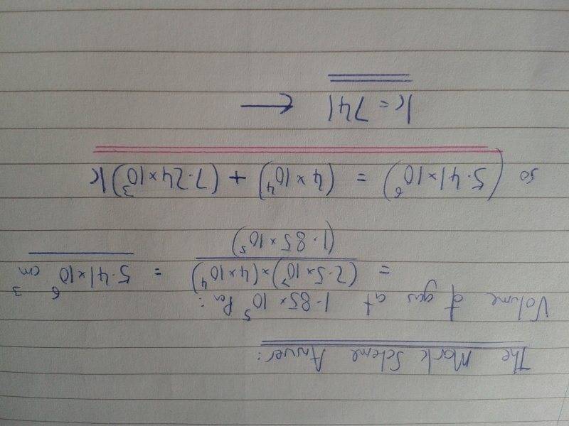

A gas cylinder contains 4x10^4 cm cubed of hydrogen at a pressure of 2.5x10^7 Pa and a temperature of 290 K.
The cylinder is used to foll balloons. Each balloon contains 7.24x10^3 cm cubed of hydrogen at a pressure of 1.85x10^5 and a temp of 290K when full.
Find the number of balloons that can be filled from the cylinder.

The number of moles is not important. pV = nRT so pV = constant because you have a fixed amount of gas at a fixed temperature and R is a constant. What you want to know is how much volume the gas will fill when the pressure is reduced to 1.85* 10^5. If pV is a constant you can find this volume, then how many baloons can be filled with this volume?

Jamessamuel said:
Off by about 5 balloons
five balloons is about the volume of the cylinder. Doesn't that ring a bell ?
What you say about the gas changing volume with pressure makes sense.
I do not understand the pink line.
Apologies for the upside down - nature of the image.
That pink line doesn't make sense. The number on the left is the volume the gas in the cylinder will occupy while subject to the new pressure. Now you can forget about the cylinder and think about how many balloons this volume can fill.
Also its good practice in general to not write out numbers and use letters instead, use the letter p, for pressure, V for volume and label them 1, 2 etc.. This way you can check your working.
So the additon on the pink line is incorrect?
Also, is it better to work algebraically before involing numbers because a bunch of numbers make the method more vague?
Think about what it all means. You have some pressurised gas then you de-pressurise it and it expands. This new volume, V, you have calculated is at the correct pressure to fill a balloon of a volume u. So how many balloons?
Yes that's also true, its more difficult for other people to follow your working.
