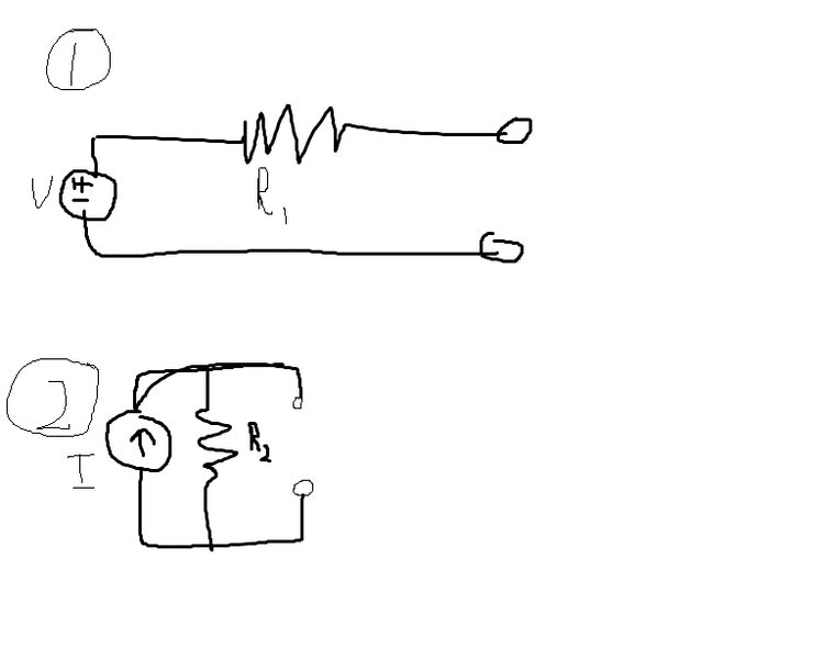

Is 1 an ideal voltage source?
Is 2 and ideal current source?
i was solving a noninverting amplifier circuit and i was asked to find out output impedence.
and in the first circuit output voltage was independent of the load resistence => output impedence=0 så it should be the first fiqure i have drawn. because output acts as a perfect voltagesource.
I the other question
i found out that current throug the load resistece was independent of the load res.
then out impedence should be infinity.
Does out put acts as a idela current source ?

forgot the picture

Basically, in a non-ideal source (current or voltage), you will notice three things that separate it from its ideal counterpart:
1) It heats up.
2) The voltage drop is a function of the current.
3) The power it's able to provide is finite.
This behavior can be simulated (for a reasonable range of the current and the voltage drop) by adding a resistor in series with an ideal voltage source, and a resistor in parallel with an ideal current source.
So, as your diagrams represent, neither is an ideal source.
but when the output voltage across a load is independent of the load they say in the book that out but acts as a ideal voltage source.
and that the output impedance =0 (can someone explain why it shoulde be 0) and if it is zero then is is same as the diagram 1
I am talking about op Amp.
In order to answer the question of whether 1 is an ideal voltage source and 2 is an ideal current source, we need to define what an ideal source is. An ideal voltage source is one that maintains a constant voltage output, regardless of the load connected to it. Similarly, an ideal current source maintains a constant current output, regardless of the load connected to it.
In the case of the noninverting amplifier circuit, the output voltage is independent of the load resistance, which means that the output acts as a perfect voltage source. This is because the ideal voltage source maintains a constant voltage output, regardless of the load resistance. Therefore, the output impedance is 0, as stated in the first figure.
In the other question, where the current through the load resistance is independent of the load, the output impedance should be infinity. This suggests that the output acts as an ideal current source, which maintains a constant current output, regardless of the load resistance.
