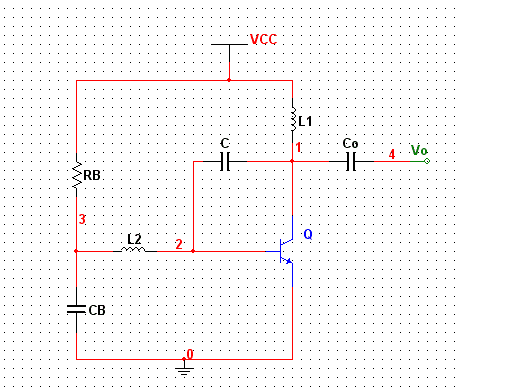

hello;
i have this past paper question relevant to a oscillator
they have given the following schematic and question is
"identify the type of oscillator giving reasons"
i tried lecture notes,some books but couldn't figure out this is a hartely or colprits or any other type,i don't see this circuit has standard tank circuit.
can someone help me with this?
Assuming CB is large enough to have negligible reactance, the resonant "tank" is made up from L1, C, and L2. The resonant circuit is completed via the power supply.
