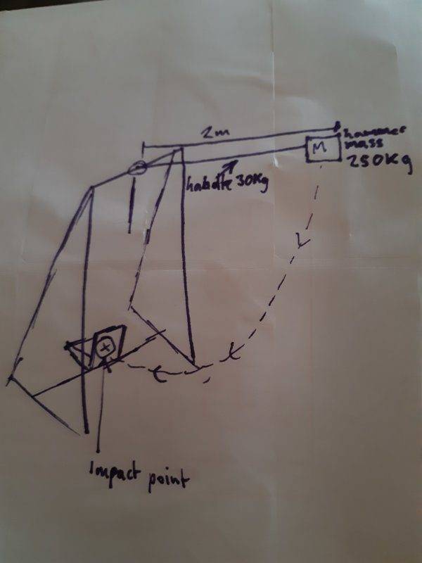

Hi all,
I have just started work experience at an engineering company in the design department. I've be tasked to develop a test rig, Similar to a charpy rig. Intended to measure the impact strength of materials.
The design will consist of an A-frame structure with swing arm attached to the top axle, on the end of the swing arm is an anvil mass. The arm will swing and strike test pieces which are fixed to a solid, flat steel block fixed at the point of 0°
These numbers are just an example for the purpose of understanding how to do it and as accurately as possible.
Length of swing arm (inc anvil) =2m
Mass of anvil = 250kg
Size of anvil = 200x200x300mm
Mass of swing arm = 30kg
Starting position of swing arm = 90°
Strike point is 0°
Bearings on axle = 100mmOD.. 50mmID
Bearing friction = 0.002ų
Everything will be made from hardened
steel
My initial thought was the impact force wouldn't be overly difficult but after some research it seems to be much more complicated. I am beginning to think I've been setup with lack of information. Any help or advice on how to go about this problem/ what variables are missing would be much appreciated. Attached a rough sketch In case there's any confusion on the construction.
Many thanks
Jay

I would anchor that A-frame to the ground very well, or it will swing around that mass of 250 kg attached to a 2-meter arm. :smile:
Second consideration would be reinforcing that bridge element between both halves of the A-frame, so it would be rigid enough under impact.
What do you want to calculate first?

That's why the Charpy test measures energy to fracture the specimen. Energy absorbed is easily measured using a pendulum. There are three ways to measure impact force.
1) A load cell at the point of impact. This is tricky because there are non-obvious error sources due to the frequency response of the load cell, getting the impact force centered on the load cell, and the mounting of the load cell.
2) Strain gauges on the structure supporting the specimen. Getting halfway usable results from this requires a deep knowledge of the relationship between impact duration, impact force vs time, and the natural frequencies of the structure.
3) Put an accelerometer on the backside of the hammer. Getting halfway usable results from this requires a deep knowledge of the relationship between impact duration, impact force vs time, and the natural frequencies of the hammer itself.

Hi, many thanks for your reply :)
At this stage it is purely theoretical and in the design stage to see if this type of thing would be a feasible option for a specific application, or if the company should go for another testing route.
I haven't received the exact data yet so I've just input some made up numbers to get started and figure out the process of what I need to do.
I do know the impact force required will be pretty high so the structure will have to be extremely strong and possibly too large to be realistic, which I need to identify. The design is also not limited to the A-frame. A drop rig or vertical lever falling to the ground are other options I'm looking at.
As for what I'm trying to calculate, Essentially I'm looking how to find the maximum impact force the rig is capable of. This is to ensure the material in the test will be suitable for the final application.

You can estimate the maximum impact force by making some assumptions:
1) The test specimen does not fracture or yield.
2) Assume the largest, stiffest, test specimen.
3) The test fixture is anchored to a "large" concrete block. Think a couple tons.
4) The anchors do not yield or fracture.
Calculate the stiffness of the test specimen and supporting structure, assuming that the support structure is fastened to a rigid body (the concrete block). You will probably need FEA. The 250 kg hammer (and its arm) has a maximum starting height. From that, calculate the maximum potential energy. That potential energy is transformed to kinetic energy at the bottom of its swing. When a mass with kinetic energy hits a spring, the kinetic energy is transformed to potential energy in the spring. At the instant that the mass comes to a stop, all of its kinetic energy is potential energy in the spring. The equation is 0.5mv^2 = 0.5kx^2. Knowing the maximum spring deflection and the spring constant, calculate the maximum force.
The calculated maximum force is directly transmitted to the concrete block, so the specimen attachment (vise?), its mounting structure, and the attachment to the concrete block all need to be designed for that force. They need to be designed for repeated application of that force.

I am not an engineer. But I recall (*somewhere? the Charpy test does not directly measure Force but in fact is a prescribed test to measure materials relative strength under impact. I think the pendulum rig is the most reliably repeatable way to do this an you can easily change the mass and lengths involved.You can instrument the heck out of it pretty cheap these days

I'm not an Engineer but hope to be one. It's an unpaid placement to get workplace experience. The design of the rig was specifically sketched out to me in three ways. They seemed keen on the design I recreated in my crude sketch. From what I understood it's a one off test for a heavy tracked vehicle component. (If it's not just an exercise) but that's what I was told.
Perhaps I'm getting a little confused but charpy wasn't mentioned. It's just the closest thing I've come across to what they asked for. I'm aware it wouldn't produce the same results. The brief wasn't for the rig to measure force but to design the rig it so it exerts a set force on the material, ensuring it will handle the impact.
I was only given the task friday afternoon so I will get more details next week. Very possible I have missed something.

I have a feeling you're right and I've made a mistake thinking it was impact force when intact it is strength ^^

Yes, specifically the purpose is to measure fracture energy (as @jrmichler said), not force.

...well, wait -- are the people you are working for engineers? You are saying they sketched-out a device and you figured out it looks a lot like a Charpy test rig?
Here's the most interesting thing I learned from using one in college: Very strong materials may also be very brittle, which means that when hit in an impact they break easily. Softer (more ductile) materials will bend and may absorb more energy before fracturing. Think iron (very strong in tensile strength but snaps with little energy) vs aluminum (can bend far without breaking).

Highly skilled engineers, world leading for military applications. Yes their sketch was identical to the one I posted. Along with another one that's the same but in a horizontal orientation and a final one which was a vertical drop.
That's pretty much what I figured, certainly looks like I've made an error with my understanding. If you don't mind I will give an update when I find out for sure what silly mistake I've made. Glad I started this thread it has helped me to atleast get a list of questions made up. Great forum.
