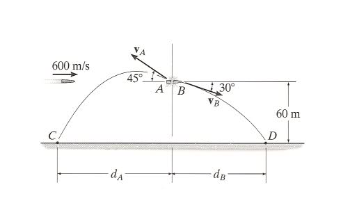

A 4-kg projectile travels with a horizontal velocity of 600 m/s before it explodes and breaks into two fragments A and B of mass 1.5 kg and 2.5 kg, respectively. If the fragments travel along the parabolic trajectories shown, determine the magnitude of velocity of each fragment just after the explosion and the horizontal distance dA where segment A strikes the ground at C.
mAVA1x + mBVB1x = mAVA2x + mBVB2x
(1.5 kg)(600 m/s) + (2.5 kg)(600 m/s) = (1.5 kg) VA2cos(45) + (2.5 kg) VB2cos(30)
2400 kg m/s = (1.5cos(45) kg) VA2 + (2.5cos(30) kg) VB2
Solving two unknowns?

If you have 2 equations that are both derived from a third one, they aren't independent. So you're stil one equation short. Try conservation of momentum in the vertical direction.
