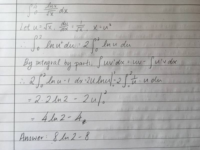

improper integral
(attached)
Whats wrong with my calculation?
I cannot figure it out after hours...
Thank you very much!
In the substitution, it's actually ##\frac{du}{dx}=\frac{1}{2\sqrt{x}}##.
Likes yecko
oh yes. thank you
