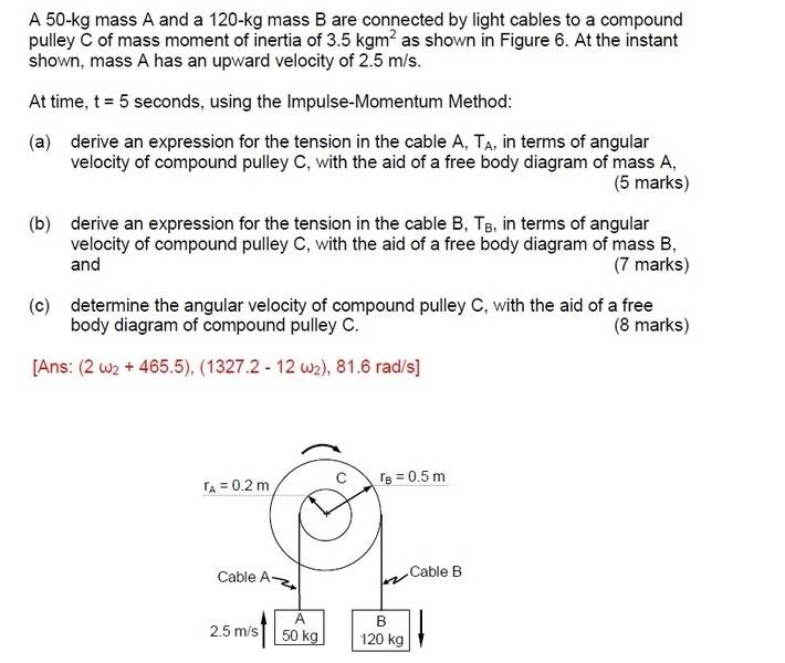

I have abit of problem understanding this 2 question, I would appreciate if someone can guide me along.
For diagram 1 (Left)
I interpret the condition as: At 0sec, initial velocity is 0, At 5sec final velocity is unknown.
For diagram 2 (Right)
I interpret the condition as: At 0 sec, initial velocity is 0, At 3sec final velocity is 14.5m/s
Please let me know if I get any of the condition wrong, thank you.
