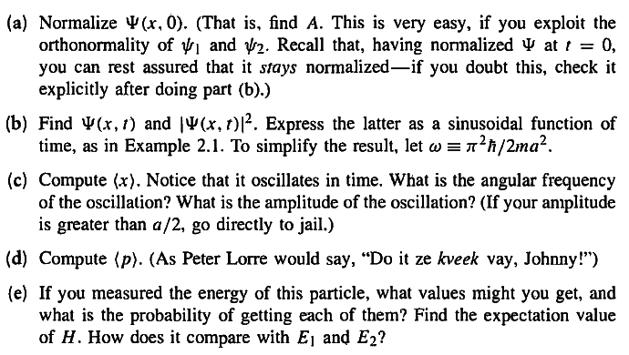

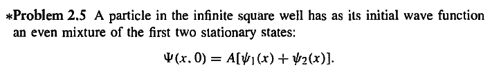

(a)
$$ \int_{0}^{a} \mid \Psi (x,0) \mid^{2} \hspace {0.02 in} dx = 1 $$
$$ \int_{0}^{a} \mid A[ \psi_{1}(x) + \psi_{2}(x) ] \mid^{2} \hspace {0.02 in} dx = 1 $$
Since the ##\psi_{1}## and ##\psi_{2}## are orthonormal (I don't know how to call ##\psi(x)##)
$$ \int \psi_{m}^{*} \psi_{n} \hspace {0.02 in} dx = \delta_{mn} $$
Where ##\delta_{mn}## is the kronecker delta. I suppose that the probability density will be
$$ \mid A^{2} \mid (\psi_{1} + \psi_{2})(\psi_{1}^{*} + \psi_{2}^{*}) $$
$$ A^{2} \int_{0}^{a} (\psi_{1} + \psi_{2})(\psi_{1}^{*} + \psi_{2}^{*}) \hspace {0.02 in} dx = 1 $$
$$ A^{2} \int_{0}^{a} \psi_{1} \psi_{1}^{*} + \psi_{1} \psi_{2}^{*} + \psi_{2} \psi_{1}^{*} + \psi_{2} \psi_{2}^{*} \hspace {0.02 in} dx = 1 $$
$$ \int_{0}^{a} (1 + 0 + 0 + 1) \hspace {0.02 in} dx = \frac {1}{A^{2}} $$
Thus I evaluate ##A = \frac {1}{\sqrt {2a}}##
(b)
I know for the infinite square well, the constants ##c_{n}## are found from this equation
$$ c_{n} = \sqrt {\frac {2}{a}} \int_{0}^{a} sin(\frac {n \pi}{a} x) \Psi(x,0) \hspace {0.02 in} dx $$
$$ c_{n} = \sqrt {\frac {2}{a}} \int_{0}^{a} sin(\frac {n \pi}{a} x)\frac {1}{\sqrt {2a}}(\psi_{1}(x) + \psi_{2}(x)) \hspace {0.02 in} dx $$
$$c_{n} = \frac {1}{a} \int_{0}^{a} sin(\frac {n \pi}{a} x)(\psi_{1}(x) + \psi_{2}(x)) \hspace {0.02 in} dx $$
But since I don't know what ##\psi_{1}## and ##\psi_{2}## are as functions of ##x##, I can't integrate.

Hi Maylis,
You made a slight error here in evaluating the normalisation constant. Two ways to see it is incorrect is to note that you have it expressed in terms of a dimensionful quantity and that conservation of probability ##\sum_{i=1}^2 |c_i|^2 = 1## is violated where ##\Psi(x,0) = c_1 \psi_1(x) + c_2\psi_2(x)##.
Then that means I am probably wrong about my definition of ##\mid \Psi (x,0) \mid^{2}##. What should it be?
Your error is that the second line here doesn't follow from the first.
The real error you made in the normalization resides in the use you made of the orthonormality relations of the eigenfunctions: it is not the simple product of the two eigenfunctions that must result 1 or 0.
In a): If ##\psi_1## is normalized, that means that ## \int_{0}^{a} \psi_{1} \psi_{1}^{*} \; dx = 1##
In d): Funny book, Griffiths. Quoting Peter Lorre means being from way long ago. But it says 1995.
In b) you in fact embark on re-calculating the two ##{1\over 2}\sqrt 2## that you know already from a) !
The ##\sqrt{2\over a} \sin \left ( {n\pi \over a }\;x\right ) ## you multiply with is ##\psi_n## ! (p. 26, (2.24) ).​
That's not the idea! The idea for b) is that you know how the ##\psi_n## develop in time, and therefore you also know how a linear combination develops !

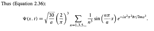

Would you have known what to answer in (b) if they had given you ##\Psi(x, 0) = \psi_1(x)## ?
@DrClaude
Okay, I see my error, thanks
@BvU

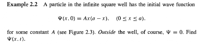

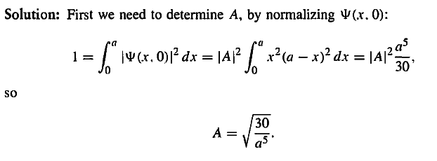

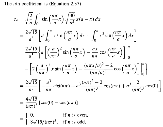

I was just using this example problem as a basis for learning how to solve ##\Psi (x,t)##. I just try to copy their technique.
And to answer you question, I would do the exact same thing as the example problem did no matter what they told me ##\Psi (x,0)## is equal to.
First they find A, then they start doing stuff with ##c_{n}##, so I tried to copy that
The thing is that finding the ##c_{n}##'s is trivial in the case of problem 2.5.
I need some sort of methodical way of solving these problems. If every problem has a different way of finding ##\Psi (x,t)##, I will have no clue what to do. So after solving for A, what is the next step? I try and do what is reasonable and use example problems as springboards for solving problems in the textbook.
You need to understand what the different steps are, and why they are used. The time-dependent wave function is given by eq. [2.17]. To solve it for a particular problem, you need to know the coefficients ##c_n##. In example 2.2, where you have the functional form of ##\Psi(x,0)##, you find the coefficients ##c_n## using eq. [2.34]. In problem 2.5, you do not need to carry out the integral of eq. [2.34]: you should be able to make a link between the given ##\Psi(x,0)## and eq. [2.16].
