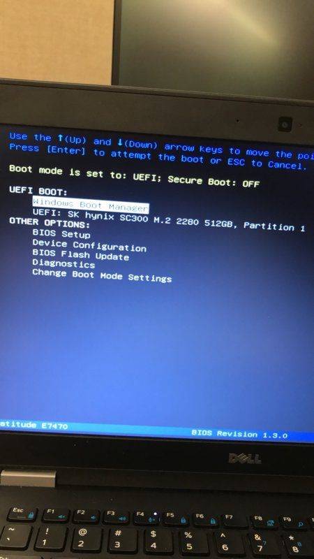

Hi PF!
I'm trying to run Ubuntu on a Dell with Windows 10. I followed the instructions on the Ubuntu website, but I'm not getting the screen suggested here: https://tutorials.ubuntu.com/tutorial/tutorial-install-ubuntu-desktop#2
What I've done: downloaded Ubuntu from here: https://www.ubuntu.com/download/desktop
and copied it to an external hard-drive. Plug hard-drive into PC. Disable SECURE BOOT on PC. Restart PC pressing F12 as suggested here: https://www.dell.com/support/article/us/en/19/sln301754/how-to-install-ubuntu-and-windows-8-or-10-as-a-dual-boot-on-your-dell-pc?lang=en#BIOS
The screen I receive at start-up is attached. But if I click on boot manager or UEFI I do not get an option to run Ubuntu. Any help on what I'm doing wrong is greatly appreciated.

joshmccraney said:
... and copied it to an external hard-drive.
That won't work, you cannot make an external hard drive bootable that way. Follow the instructions on the page you linked to install from a USB drive or a DVD instead.

On that screen, windows boot manager is the first option listed under UEFI, so, per the instructions at top of the screen, you can use the +- keys to change the order.
But the USB drive has to be bootable, and that requires more work than just copying the iso file to the external hard drive. The file you downloaded is a .iso file. It's about 2GB in size, so it will fit on a DVD or flash drive. You need to burn it as a bootable image; not just copy the file.

DO NOT select/attempt BIOS flash update!. That's for firmware updates to the BIOS. If you follow that path, and do it wrong, you could hose your machine so that it would be completely useless until someone re-flashes the BIOS with exactly the right firmware.
It would be fine for you go to Other Options > Bios Setup, though -- please read on.
In the screen you showed in post #1, your UEFI device Partition 1 was a 512GB HDD -- presumably, that was the external HDD you had intended to use for Ubuntu.
First, I suggest that you should make a backup of your Windows HDD, just in case, sometime after wiping it out, you wish you hadn't.
You said in post #1 that you were running a Dell, so the following is predicated on that:
Plug in your bootable USB device, or, if you're installing from a DVD, put the DVD in the drive (before you exit Setup, which the next sentence will tell you how to enter).
Immediately after the Dell splash screen, instead of pressing F12 to get the boot menu, press F2 to get into Setup.
Then navigate to the boot order options, and move USB (or DVD) to the top of whatever list it appears on (if you say your Dell model number, I could be more specific).
Then press F10 to save and exit.
The machine should now boot from the available devices in the order you chose in Setup.
You should see the new device order if you press F12 during a reboot.

Got it! Worked. Thanks so much! Ubuntu ready! Thanks all!
