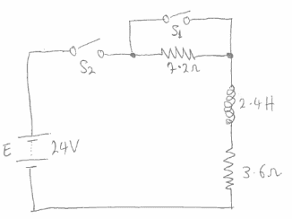

In the inductive circuit shown in Figure 2, the switch S1 is closed 0.75s after switch S2 is closed. Calculate the instantaneous current in the coil 1.5s after switch S1 is closed.
T=L/R
I=V/R
When S2 is closed:
T=L/R
=2.4/7.2
=0.333
=333ms
IMAX=V/R
=24/7.2
=3.33A
At time 0.75s S1 is closed, the current is:
i1=IMAX(1-e^-t/T)
=24/3.6(1-e^-750/333)
=5.97A
When S1 is closed current flows through the 3.6ohm resistor and decays:
Time constant is:
T=L/R
=2.4/3.6
=0.666
=666ms
Current after 1.5s after S1 is closed:
i2=i1e^-t/T
=5.97e^-(1.5x10^-3/666)
=5.97A
This cannot be correct?

What's the total resistance in the series circuit when only S2 is closed?
7.2ohms+3.6ohms = 10.8ohms
I get an answer of 6.44A for i1 and i2
That doesn't look right to me. Can you show some details?
What was the current just before S1 closed?
After S1 closes, what final current is the circuit heading for?

Why didn't you use the IMAX value that you found? You've dropped the 7.2 Ω resistor again.
Edit: Sorry, I just realized that you were writing an expression for I(t) for the second circuit and that you're implying a new IMAX. Two problems though, you used the same time constant as for the previous circuit configuration (it should change when the total resistance changes), and you didn't take into account the initial current that the circuit starts with at the instant S1 closed.
Why does it decay? What is the final current that the circuit is heading for with a 24 V supply and 3.6 Ω? Is this current smaller or greater than the initial current (at the instant S1 closes)?
Final current is I=V/R 24/3.6=6.66A the 7.2ohm resistor is bypassed when S1 is closed? The current is greater because when S1 is open we pass through both the 7..2ohm and 3.6ohm resistors.
Which step looks wrong to you? Am I even headed in the right direction with my attempt?
You haven't determined the current in the circuit for the instant *before* S1 closes. That current is the result of the the initial configuration (with both resistors) running for 0.75 seconds. That current is also the initial current that the new configuration starts with when S1 closes. You need to take that initial current into account.

Okay how does this look:
When S2 is closed:
T=L/R
=2.4/10.8
=0.222
=222ms
IMAX=V/R
=24/10.8
=2.22A
i1=IMAX(1-e^-t/T)
=24/10.8(1-e^-750/222)
=2.15A
When S1 is closed current flows through the 3.6ohm resistor:
Time constant is:
T=L/R
=2.4/3.6
=0.666
=666ms
i2=i1e^-t/T
=2.15e^-(1500/666) Note: 1.5 seconds = 1500ms right?
=0.23A

Right. Now from this value, the current increases exponentially to 6.66A when S1 is closed. Write an equation which gives you i=2.15A for t=0 and i=6.66A for t=∞.(assuming S1 is closed at t=0)

So you know that the current will start at 2.15 A and head towards 6.67 A, following an exponential curve. How might you write an expression for this?

What is the total amount that the current can grow from initial to steady state? (i.e. what's the ##ΔI##?)
ΔI=6.67-2.15=4.52A
Right. So the current will be tending to grow by 4.52 A over time. It will follow an exponential curve as you've used in previous parts. 4.52 A will be the magnitude (your "IMAX") for that curve. This growth sits on top of the initial current. So:
$$I(t) = I_o + ΔI(1 - e^{-t/\tau})$$
It=2.15+4.52(1-e^-(1500/666)
=6.19A
That looks good.
