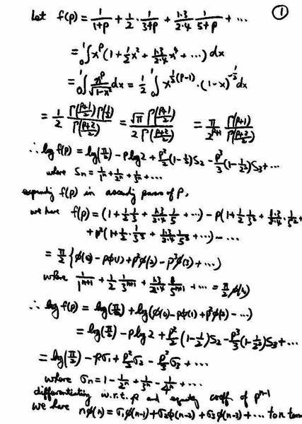

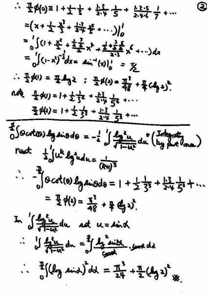

I am sorry , the integrand should be (log(sin(x)))^2 and the interval is (Pi/2, 0) .-Mathslover
Use a numerical formula (i.g, Gauss's).
I would like to find the definite integral of (log(sin(x)))^2 under the interval (pi/2,0)
Numerical integration can only give a numerical answer
I would like to find the above integral in terms of well-known constants
-Mathslover
Reading through "Ramanujan's notebook Part 2" and "Collected Papers of Ramanujan ",
I chanced upon an entry which solved my problem beautifully.
I just wish that much more can be learned from Ramanujan's work.
-mathslover
Devilishly Clever! Can the argument be extended to deal with higher powers?
The beautiful point about this calculation is that it is applicable for all positive integers.
Define I(n)=Int((log(sin(x)))^n, {x=0 to pi/2}) then it can be shown that
I(0) = pi/2
I(1) = -(pi/2)*log(2)
I(2) = (pi^3)/(24) + (pi/2)*(log(2))^2
and I(3) is a function of log(2) , pi and Zeta(3)
-mathslover
