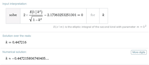

I agree, using a numerical method would be easier. Here is my method:
Using
pasmith said:
##\frac{B}{\sqrt{1 - k^2}} E(1,k) - C = 0##
I can find ##k## as a root
Rochefort said:
when knowing the values of [itex]B[/itex] and [itex]C[/itex]
For example, when ##B=2## and ##C=2.17363253251301
## (I know ##A=1## using my Riemann sum) $$\frac{2E(1,k)}{\sqrt{1 - k^2}}- 2.17363253251301 = \dfrac {2\int ^{1}_{0}\sqrt {1-k^{2}\sin ^{2}y} dy}{\sqrt {1-k^{2}}}-2.17363253251301=0$$ When I type this into Wolfram|Alpha I get what is in the "Attached Thumbnails."
Using
pasmith said:
##A = \frac{Bk}{\sqrt{1 - k^2}}##
$$A ≈ \frac{0.447215806740405B}{\sqrt{1 - 0.447215806740405^2}}=\frac{0.447215806740405\cdot 2}{\sqrt{1 - 0.447215806740405^2}}≈1.00000618061640...$$ Which is accurate enough.
Now my question is, how could I - when knowing the values of ##B## and ##C##- find ##k## using numerical methods? I want to be able to use this method in excel i.e. to be able to use multiple columns to determine ##k##."
