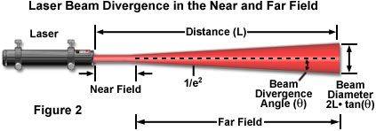

EDIT: maybe these images will help your understanding? (Don't worry too much about the captions included with the figures, I'm posting these mainly for illustration and have added some explanatory notes of my own)
The dotted line is the central axis of the beam.
"r" represents the distance above or below that line.
Here "x" is what we are calling "r".
The circular-shaped figure represents the beam intensity, with the beam directed out of the plane of the page.​
