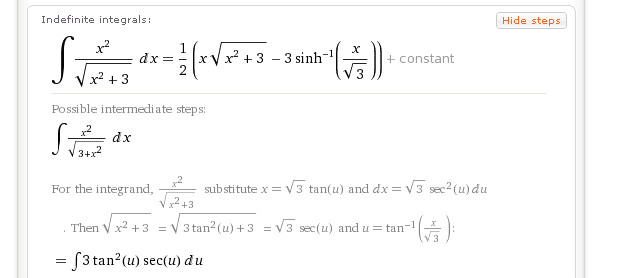

I still don't get it. I need more of a step by step. coming to the solution wolfgram comes to:
I see how you decided what x is, but I don't see how they decided what u was.
The crucial point is that you have [itex]\sqrt{1+ a^2}[/itex] and want to get rid of the square root. You should immediately think of the trig identity [itex]1+ tan^2\theta= sec^2\theta[/itex].
