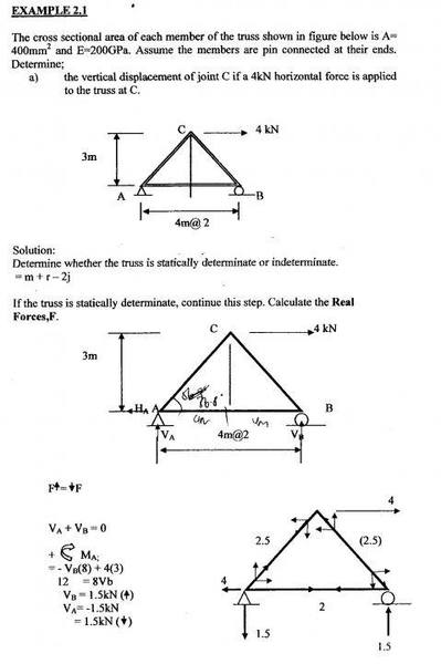

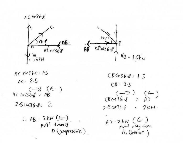

For this problem , i found that the internal force AB at point A and point B pointed in the same direction ( as shown) in my working , so , how they cancel off each other ?Since they can't cancel off each other , so they are not stable , right ? The structure is statically indeterminate ?
It's in the 3rd photo [/B]

you forgot to consider the horizontal force reaction.
Likes fonseh
which
one ? which part ? Can you point out ?
see your first attachment , bottom of page, sum of forces in x direction = 0.
Likes fonseh

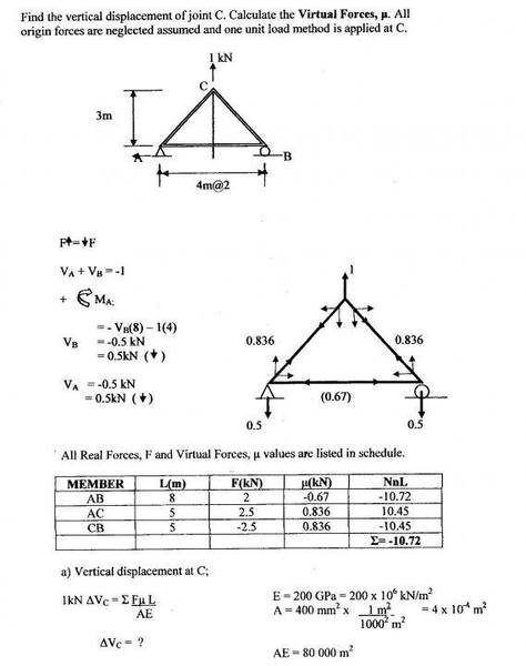

One more question here , how to get the value of µ ? It's not stated in my textbook what is it ... And what is the usage of µ ?
