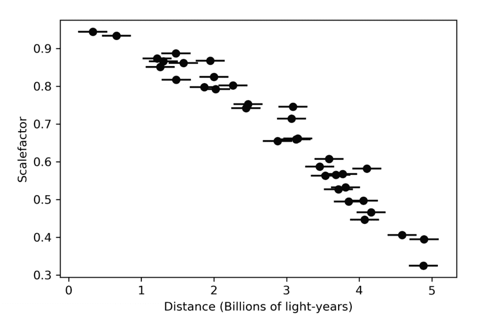

Hi guys, I'm having trouble with interpreting scale-factor and distance graphs of Type 1a supernovae.
'Imagine that you live in a different universe, which may have a different cosmology to our own. You measure the distances to and redshifts of a large number of Type Ia supernovae, and you use the redshifts to calculate the scale-factor of the universe at the time when the supernova exploded. You get the following graph of distances and scale-factors.'
The question is asking to deduce as much as you can from the plot below:

So what have you come up with so far?
What is the meaning of scale factor here?
From the graph you can find the Hubble distance and, if the speed of light is same for that universe, you can extract the Hubble constant for that universe. And by using Hubble constant you can find the Hubble Time. And that's all I guess

i've calculated redshift and velocities so far, but haven't really gotten far with the question otherwise

And are you going to tell us what you got for those things?

so for redshift i got 0.53, and from then i calculated the Hubble constant to be 7.6e24m/s. I am struggling with how to interpret these findings.
you have missed an important bit off the end of that
Thats not quite right. First redshift value for what object ? Redshift is not some sort of a general property of space. You can find the corresponding redshift for an object, that has a distance d.

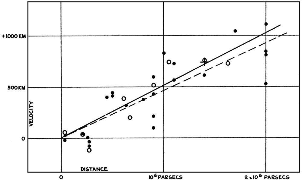

From the graph its clear that there's a linear relationship between ##z## and ##d##. This was what Hubble observed in 1920.
Here the y axis, velocity, is just ##cz## since ##z = v/c##. The x-axis represents the distance in parsecs.So the graph that you are given can be turned into Redshift vs Distance (##z## vs ##d##) graph. (You don't have to do that of course). And from that it can be turned into velocity vs distance graph which that is what Hubble did.
And you also know that, this linear relationship can be written as,
##cz = H_0d##
So from your graph we can find the value of the ##H_0/c## or the Hubble distance by turning the scale factor into redshift for 2 points and measuring the slope of the line that connects these two points.
Now, if we assume that ##c## is the same in this imaginary universe as well, we can find the ##H_0## (If we cannot assume that ##c## is the same, then the only information you can get is ##H_0/c##)
Do your calculations again. But be careful about the units. In your graph the distance is given as billion light years. However Hubble constant has units of ##kms^{-1}Mpc^{-1}##.
