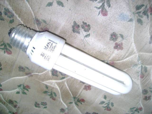

As far as I know, Compact Fluorescent Lamp (CFL) is an inductive load.
I understand that inductive load doesn't allow an immediate change in current. When the circuit was initially open (through open switch) then became close, the inductive load was energized. So opening again the circuit after a long period of time makes the inductive load to have enough energy to maintain its magnetic field, so voltage as well (I know it was called back emf).
I am afraid that our CFL at our bathroom will eventually find its time to break ( or unfortunately to blast and cause fire). Since it's a bathroom,the CFL is being switch on and off frequently. How do I manage to create a switch or circuit to avoid that back emf (or even reduce) which causes the low lifespan of our CFL thus preventing cause of fire (As my conclusion). I have seen in the internet about putting a flyback diode helps to prevent back emf but it is new to me so I need guidance.
So my query here is: I really don't know how to make a circuit for better switching of our CFL to prevent or reduce back emf , improve even a little bit the life span of the CFL and to avoid danger and fire. Please kindly help me. you can propose a circuit or help me to make one.
This is our CFL having 18 W, 220 VAC, 60 Hz:
Kindly help me to solve this problem to prevent any danger in our house.
By the way this can't be replace because it was preferred by our family members (yeah all of them).

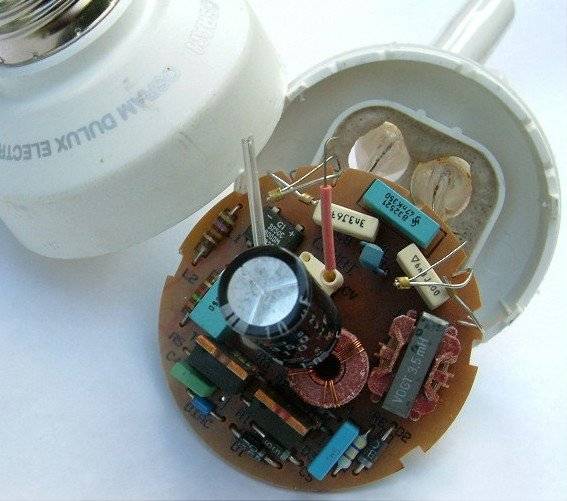

I don't think there's enough induction to worry about as it uses a "switching power supply" (ballast) that's in the CFLs base.
Electronic ballasts contain a small circuit board with rectifiers, a filter capacitor and usually two switching transistors. The incoming AC current is first rectified to DC, then converted to high frequency AC by the transistors, connected as a resonant series DC to AC inverter. The resulting high frequency is applied to the lamp tube.

Where i live CFL's are a capacitive load not an inductive one. Switching one on draws a big gulp of current.
In one room of my house it causes the touch-dimmer equipped incandescent lamps to turn off. So does switching on the computer. I think the neutral for that room's outlets is routed improperly creating a loop antenna.

Modern CFLs are electronically ballasted. Current they draw is typically heavily distorted. Displacement power factor is leading which means they present more capacitive than inductive load to the feeding network. Knowing their harmonics contaminate the network, that they are not as "green" as advertised, and die on average in service earlier than claimed by manufacturers, I don't like them at all. I don't have a single CFL bulb installed in my house.

So are you all telling me that I should not mind the effect of switching (frequently) of CFL on our comfort room because switching frequently has no significant effect to CFL (which is an inductive load)? Is that what you want to tell me?
well, it's a capacitive not an inductive load.
In practice, switching it ON does apply a harsh transient called "inrush" to the electronic components.
If it's well designed and built it should withstand that transient repeatedly with no significant effect. That's a function of who built it. You get what you pay for.
Switching it OFF is by contrast a gentle transition.
