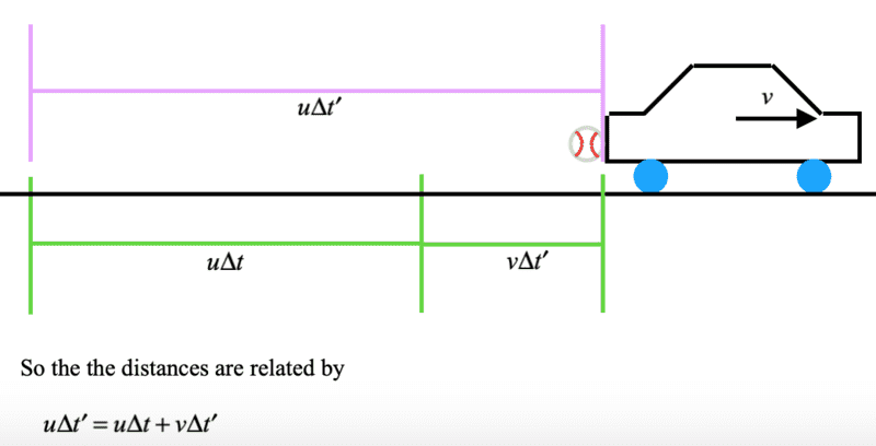

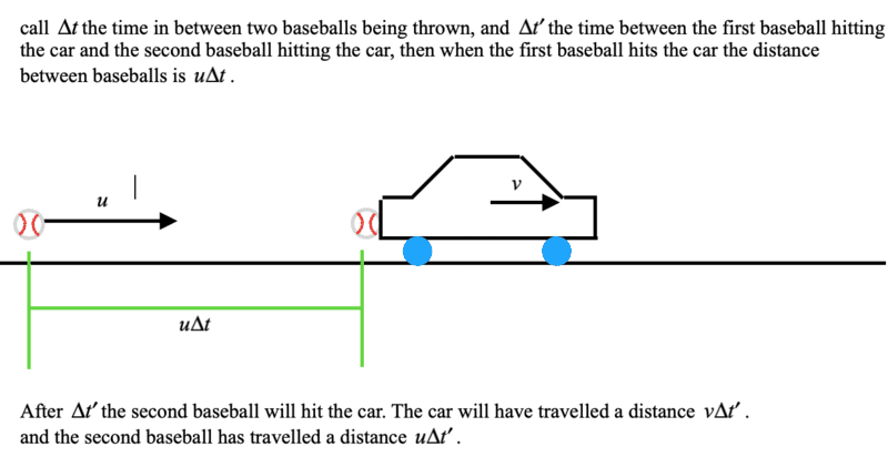

I have started drawing the case when two baseballs are thrown, and
from here I would imagine that you solve for the frequency of baseballs hitting the car. I just don't know how I can relate the frequency of balls thrown (inverse Δt) and the frequency of balls hitting the car (inverse Δt') to the mass rate of balls being thrown (σ) and the mass rate of balls hitting the car (σ' let's say).
Thanks for taking time to help me dan and haruspex!
You seem to be nearly there. If you imagine a small mass ##\Delta m## is fired in a time ##\Delta t##, then the same mass hits the car in ##\Delta t'##. That's what you've calculated.
This should allow you to relate ##\sigma'## to ##\sigma##.
Likes Nate Stevens
