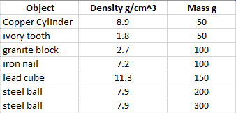

Here's a list of randomly chosen objects:
If these objects are all submerged in water, find the buoyant force on each. Then graph the buoyant force vs mass. From your graph, would you say that the buoyant force is proportional to the mass of the object?

The way this problem is setup is bit confusing. First off, density of water P = 1 g/cm3, and gravitational acceleration g = 9.8 m/s2. I would be consistent with units. You could use P = 1000 kg/m3. Second, I would use symbols that are bit easy to recognize. For example 'm' for mass and FB for buoyant force and so forth. This is not the big issue, however, since you are only trying to figure out how buoyant force is related to the mass. According to your expression, y=(x/p)* P* g, indeed y is proportional to x. But it is a false result! The reason is that you are keeping p, the density of the object, a constant.
You are attempting to change the mass x, keeping the volume constant, without changing the density! This is not possible. In other words, x and p are inter-related and that's why you are getting a false result. If you look at TSny's answer, he/she is also indirectly stating this by choosing materials of different densities!
