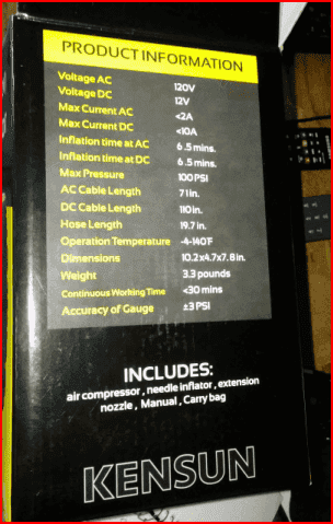

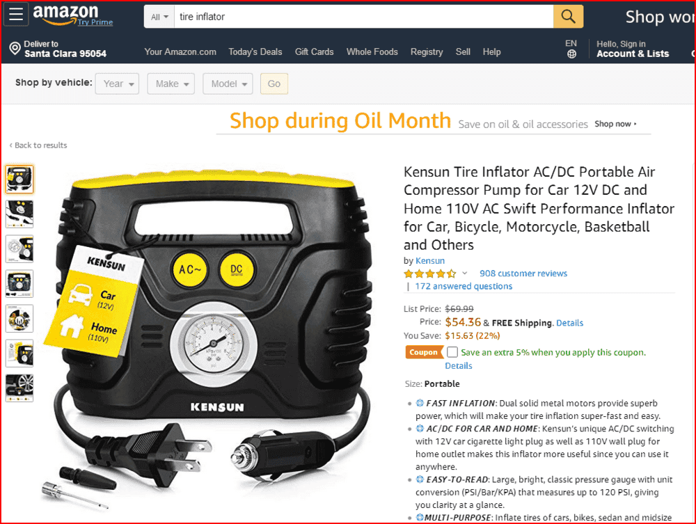

UPDATE -- I ended up buying a tire inflator that works from either AC Mains or 12Vdc. That way I can plug it into the wall outlet in my garage to top off our vehicle tires, and I can carry it with me for 4-wheeling and other situations where I will be airing down for off-road, and need to air back up when I get back on the road. I also bought a heavy duty 12Vdc extension cord to make it easier to get to all 4 tires.
So far I'm happy with the unit. We'll see how the long-term reliability turns out. :smile:

Nice find!

Mediocre in my experience, just treat them as a consumable. Most of the portable ones are piston pumps running without lubrication; air volume, and particularly maximum pressure, decrease with wear.
