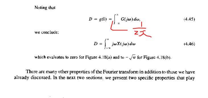

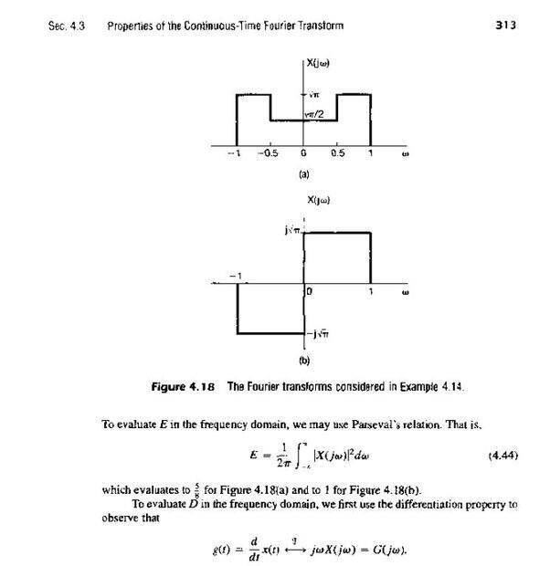

Why here is not 1/2*pi ? I don't understand . Can anybody help explain?
Can anyone help explain this issue?
It’s not a Fourier transform. ## D=\left. \frac{d}{dt}x(t) \right |_{t=0}## it’s on the previous page. They’re solving for ##g(0)## not ##g(t)## notice how the right side of the equation doesn’t have the multiply by the exponential?

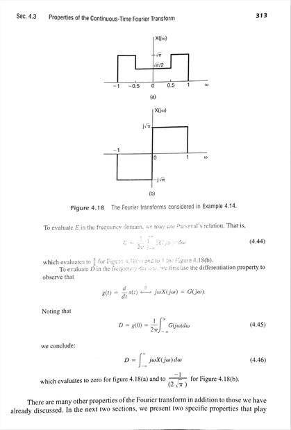

My hardcopy of the book has ##1/{2\pi}## there. Hrm i’ll have to try that when it’s not 2 am to see which copy is right. It’s not intuitive to me because of the reason above. On my phone so please forgive format or screenshot error.

Thank you very much for your reply. But I'm still confused because of g(0) comes from g(t) when t = 0 ,right?
So if we want get g(0), we should get g(t) firstly . If we get g(t) , we should use the Inverse Fourier transform. That means there should have a 1/2*pi. This is what I thought .
Hopefully you can explain more , it is very appreciated!

Great.! I think your book is right . I don't know why it is different in some edition . So this is my confused. Thank you very much!
The strange thing is mine is also the 2nd edition.
The Fourier transform would have some multiple on the right side ##e^{j\omega t}## something like
$$\frac{1}{2 \pi} \int G(jw)e^{j\omega t}\,d\omega$$
I’m a bit tired right now, but curious to give this a more thorough look tomorrow (gosh i’ll lose sleep over this but i’m already running on fumes)
…. plus what about the next line in my book equation 4.46? Something seems off.

Yes. It seems like the equation 4.46 still miss the 1/2*pi. But based on the result it seems like there is a 1/2*pi.
I wouldn't reverse engineer the answer like that. Just because the answer is ##-1/2\sqrt{\pi}## doesn't mean that the formula in 4.45 should have a ##1/{2\pi}## in front of it. I'm not sure if they were intending to do a Fourier transform there or not. Something definitely looks off, but I can't put my finger on it. If the intention is a Fourier transform, then it's also missing the exponential.
The ##\pi## in the solution might be coming from the graph in figure 4.18b. Notice there are two rectangle pulses in that graph with a height of ##-j\sqrt{\pi}## and ##j\sqrt{\pi}##. I think what the author wants us to do is to either use duality, which I'm not too thrilled about (it might be "the trick" but I'm very iffy on it), or you can multiply the given ##X(j\omega)## by ##j\omega## and use the Fourier on that result. If you multiply by ##j\omega##, then you'll have ##G(j\omega)=j\omega X(j\omega)##, which is a line ##-\omega \sqrt{\pi}##. You can do the Fourier transform of that from ##-1## to ##1## to get ##g(t)## and solve for ##g(0)##.
Alternatively you can do it without multiplying by ##j\omega## and do the derivative in time domain. It's already known that each rectangular pulse is going to have some solution in the form of ##sinc(x)##. You could get away with this doing the Fourier transform on just one and then add the two of them with different phase shift, which would multiply the solution by ##e^{j\omega_0 t}## where ##\omega_0## is the frequency shift (the left rectangle is shifted by ##0.5## and the right one by ##-0.5##).
A trick I'm thinking of is doing the derivative of ##G(j\omega)## because it'll be a constant horizontal line just ##-\sqrt{\pi}##, then post-process the answer in the time domain. I think that'll still be some ##sinc(x)## form solution because it's from ##-1## to ##1## it'll still be a rectangle, but no need to deal with two ##sinc(x)## functions with phase shift. That might be the easiest way of doing it although I'm not 100% sure if that's acceptable. I felt like I tried getting away with that during an exam to save time once and the professor didn't buy it, but I'm not sure if it wasn't bought because I took a shortcut or if it was legitimately wrong.

I have calculated with 1/2*pi . The result is the same . If it isn't there , the result is different . So trust me , 1/2*pi is miss there .
I did it by hand.
Yes: It needs the ##1/2\pi## for both 4.45 and 4.46, but I also think it's missing the exponential ##e^{j\omega t}## inside of the integrals unless some happy accident allows it to work without. Those two equations are not Fourier transforms without it. If it doesn’t have the exponential, then result would be zero.
The other thing to notice is that your book and my book has two different answers despite the graph being the same. If getting the same answer as the book is important to you in this case, then you could reasonably believe that the ##1/2\pi## doesn’t belong there. This is why I’m cautioning on reverse engineering the answer.
