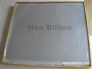

I suggest you may try to use some indium foil, which is ideal for creating vacuum seals.
For your reference, Indium creates effective and reliable helium tight hermetic seals between metals or non-metallics like glass and ceramics. For example, indium can be used to seal non-wettable surfaces in cryogenic applications, vacuum pumps and in heat-sensitive areas, etc..
When indium is used as the sealant, a chemical bond is formed between this silvery, semi-precious metal and the surfaces to be mated. Gaskets made from other materials only form a barrier to the medium being contained. Indium seals are far less sensitive to mechanical shock, vibration and low temperatures than other types of seals.
We are in a position to supply indium foil. If there is any interest, please feel free to contact me for more details. My email address is: tonyhantao@gmail.com
