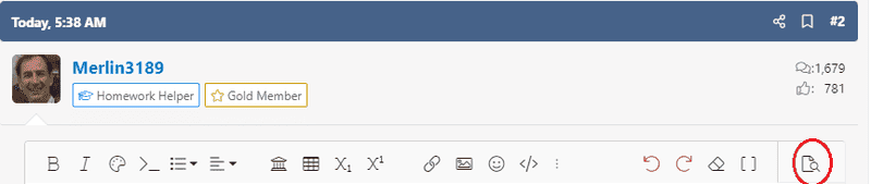

Merlin3189 said:
I can't find a Preview button?
It's the icon that looks like a piece of paper with a magnifying glass. It's at the far right in the menu bar above the text entry pane or possibly at the beginning of the 2nd row if your browser's window is reduced in width.
Here's a screen capture showing the Preview icon.
