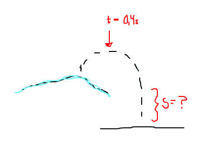

In summary, the diagram shows a kid jumping off a snow pile into the ground covered with snow. The problem asks for the height of the snow pile if the ground is at 0 m. Using the equation S=v0t+(at²)/2, the kid is at its highest point when the velocity is zero and t=0.4 seconds. However, the velocity should be negative when the kid is headed downwards. Additionally, the kid reaches the top of the layer of snow, not the ground itself.

The diagram shows a kid jumping off a snow pile into the grown that is also covered with snow. So the kid is jumping up and then lands on the ground.
https://scontent-arn2-1.xx.fbcdn.net/hphotos-xpf1/v/t34.0-12/12380374_1234806623215387_1066477107_n.jpg?oh=fe84392440a1ddbf0eebf557109d56ec&oe=5677CAA8
The question is: how tall is the snow pile if the ground is 0 m?
S=v0t + (at^2)/2
I am thinking that the kid is at its highest point when the velocity is zero and t=0.4. It takes 0.4 seconds up and also 0.4 seconds down to the level where the snow pile was at. so the snow piles height is from 0.8 seconds to 1,2 seconds. 1.2-0.8=0.4
s= -4*0.4 + (9.82 * 0,4^2)/2 = - 0,8144
What went wrong in my assumptions or solution?
If it's headed downwards, you are denoting this as a negative velocity, so g in your equation will likewise be negative.
Also, when the velocity is at its most negative point, that's when the kid reaches the top of the layer of snow that's on the ground, not the ground itself. Ponder the finish of the velocity vs time graph.
