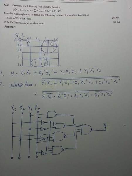

There are four variable(x3,x2.x1,x0),how should I put them on a K-map?
Is it like that?
Looks good to me except shouldn't your second term be ##X_3'X_1\,##?
