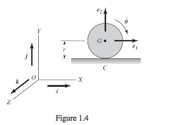

Assuming rotation only around the point G, translation of the contact point C is carried out by rotation ##\dot{\theta} ##. The velocity of the contact point is
$$ \dot{\vec{P}}_c =\vec {v_c}=\dot{\theta}r\vec{e}_{vc}$$
where ## \vec{e}_{vc} ## is the direction vector for the velocity.
However, say that you grab on to the now vertical disc in the figure and lean it towards the floor. Then, you rotate the disc around ## \vec{e}_2 ##. Clearly, the contact point ##\vec{P}_c ## will translate although ## \dot\theta =0 ##. The question is though, what is the kinematic model for this translation? I am looking for literature source or so covering this.

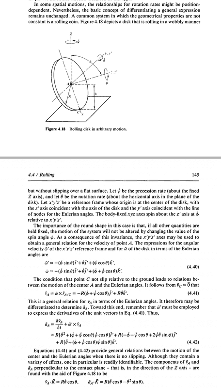

Well, that is a nice video but it does not single out the kinematic equations (as far as I could see). However, I think I found what I am looking for in
Advanced Engineering Dynamics by Ginsberg, at page 144. Below is a screenshot from Google Books that I found. As expected, the velocity is depending on the tilt ##\theta ##
