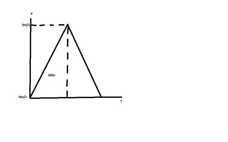

I am unable to solve part b and please help me check whether is there anything wrong with my graph..:redface:

I think you should draw the diagram roughly to scale.
The free fall acceleration should be 9.8m/s2 Thus in 1 sec. the velocity should be changing from 0 to 9.8m/s.
As you see from the graph the area first triangle is equal to 60m.
From simple formula of triangle you find the height(the velocity)
From your diagram the time= 40 sec(60=1/2vt). which wrong. After 40 sec. the velocity will be more than 3m/s.
azizlwl: So the tip of my triangle should have abit of curve?
Astronuc: Which of my velocity is incorrect? The 2 website that you listed is for me to check my answer?

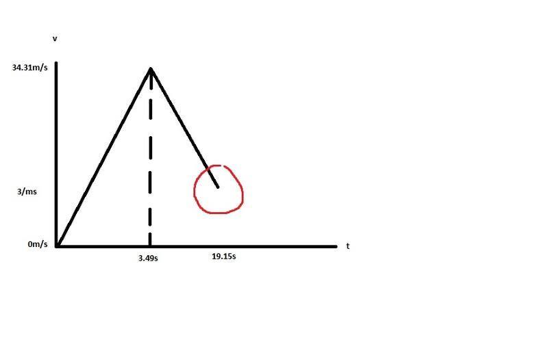

Doc Al, can you help me take a look at my velocity time graph.. I think it's wrong because it looks abit weird to me :redface: The circle part i don't know where to end it since the question says reaches the ground with a 3/ms So it cannot be 0m/s. And the initial velocity is 0 so my point has to stopped there. Is it right?
Looks fine to me except that you can make it a bit closer to scale. The final speed is 3 m/s, but compare its height above the zero mark with the 34.31 m/s height. Other than that, it's good.
