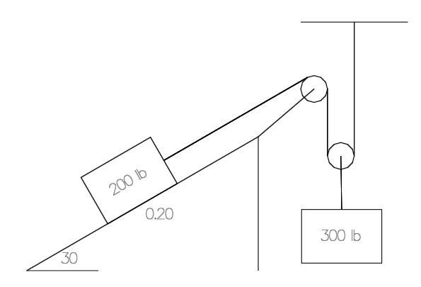

Refer to the diagram.
can someone explain why is the 300lb block moves only one-half the distance of the 200lb then the acceleration and velocity also to one half.
Hi darkmagic! :smile:
velocity = dx/dt and acceleration = d2x/dt2, so if you halve x, you halve velocity and acceleration also.
(and of course x is halved because the pulley moves only half as far as the string)
how can you know that the pulley moves only half of the string?
When the pulley goes down 1 cm, that makes the string above it 1 cm longer on both sides, which requires 2 cm of string, so the block on the slope moves 2cm. :smile:
ok thanks. another question, how can I know to which the blocks will move and how their acceleration are computed? look at the new attachment.
Just ask yourself, does the pulley move? if it does, how many strings are attached? (because each string will have to get longer or shorter by the same distance)
yes the blocks will move. my problem is in which direction will they move?
To find out, write the F = ma equations for each of the three masses.
(and, if the heights of the masses are x y and z, you'll need a linear equation connecting x y and z)
