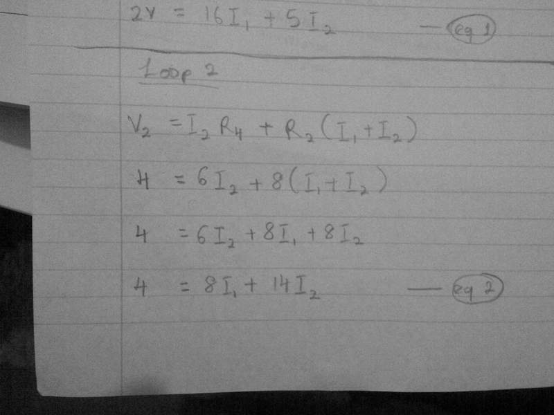

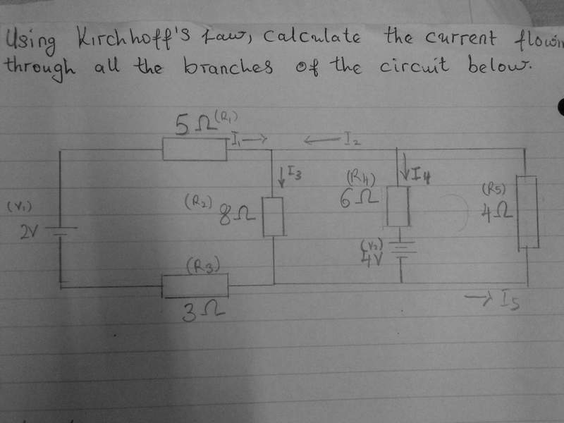

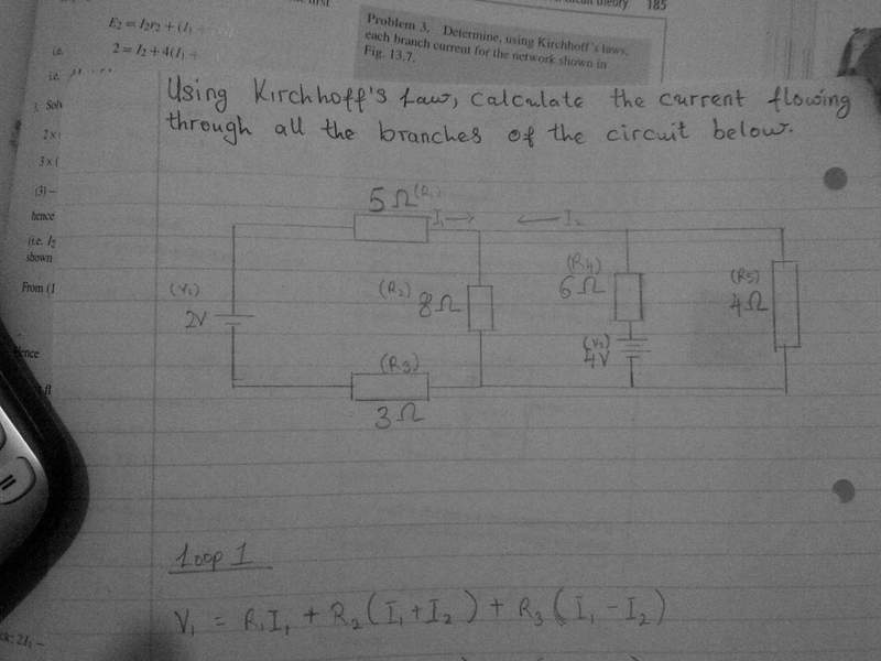

hello,i have started working on it and i got the first 2loops.i just want to make sure i am on the right path before i continue to find the third loop.which i think i'm..so please,can anybody help me out here?pleas
i have attached my attemped solution.
thank you

It might be easier to see if you label all of your loops and junctions. Including the big outer loop, you can write a total of 4 loop rules, as well as two junction rules. Try labeling the loops and junctions, as well as determining the sign of each current going into/away from the junction.
Why I1-I2 through R3
Note: there are two Kirkoff's Laws ... you appear to be trying to apply the node law simultaneously with the loop law. That is not best practice - especially with more complicated circuits where it is easy to get confused.
Yes - label the loops and nodes (junctions) on the diagram.
You will need as many equations as you have currents to find.

like this?

The thing is,this is a whole new topic to us and we were only given 2 examples and we were given this to do.and those examples were only with 2loops
Also pay attention to the direction of the current you draw. If I1 and I2 are directed toward each other, how will there be any current in the third (right-most) loop? Once you get the current directions figured out, take it one step at a time loop by loop. Keep the sign conventions in mind for writing your equations, and then it just becomes some algebra to solve for each current.

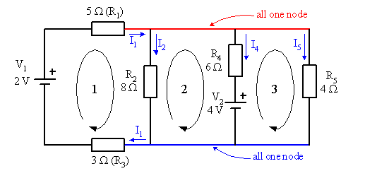

Begin by labeling your diagram to identify the loops. Then identify the nodes from which branches, well, branch from :smile: Then add a current for each unique branch. Each component should end up having a unique current flowing through it. Like this:
For convenience I chose to number the currents to correspond to the resistor number in the branch (the exception is the current I1 that flows through both R1 and R3 because they are in the same branch -- I picked the lower resistor number for the current number).
You could add a forth loop that traverses the outer perimeter of the circuit, but it is not necessary for solving the circuit: once you have every component "touched" at least once by some loop, you have enough loops.
Now you need to apply your KVL rules to write the equations. Do a "KVL walk" around each loop summing the potential changes due to voltage sources and the individual currents in the components. Then write KCL for each of the nodes. You'll find that you need to use one less node than you've identified (try it, you'll see why).

Yes. You want to sum all the potential changes as you "walk" around a loop. Think of it as walking a closed path on hilly terrain where you're keeping track of the changes in elevation.
For sources, if you "walk" through them from their - to + terminals the potential increases. If you "walk" through them from + to -, the potential decreases.
For resistors you use Ohm's law and the current assigned to that resistor. If you "walk" through the resistor in the same direction as the current, the potential drops by I*R. If you're walking against the direction of the current, the potential increases by I*R.
In this way you can add up the potential changes, writing an equation as you go.
The KVL rule is actually what you've been trying to do - probably not so formally.
Applied to loop 1, you get:
##V_1-I_1R_1-I_2R_2-I_1I_3=0##
...which is the same as:
##V_1=I_1R_1+I_2R_2+I_1I_3##
...which is close to your first equation, compare it with the examples in your classwork.
