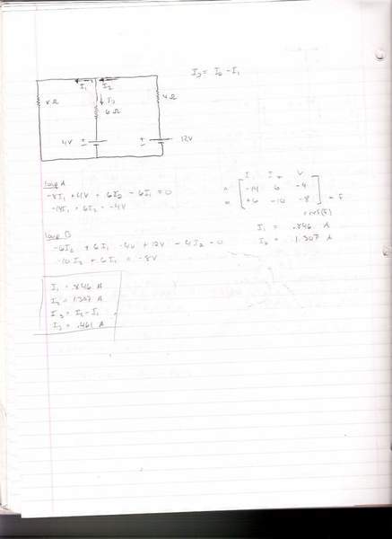

Circuit is show in my attachment. I have 3 loops with three unknown currents.
8 Ohms of resistance down the left side.
6 Ohms of resistance and a 4V battery down the center.
4 Ohms of resistance and a 12V battery down the right side.
I honestly have no idea if I'm even approaching this correctly.
Kirchhoff's Rules
See attachment:
Loop A (Big Loop)
-8I1 +12V +4I1 +4I3 = 0
-4I1 +4I3 = -12V
Loop B (Left)
-8I1 +4V -6I1 +6I2 = 0
-14I1 + 6I2 = -4V
Loop C (Right)
-6I3 - 6I2 - 4V + 12V - 4I3 = 0
-10I3 - 6I2 = -8V
combine in a matrix
I1 I2 I3 V
a -4 0 -4 -12
b -14 6 0 -4
c 0 -6 -10 8
rref()
I1 = 1.083
I2 = 1.861
I3 = -1.917
Im not entirely sure, but I think these are voltages for the loops, so from there I would set
V= IR for each of the loops to find the current, but this produces the wrong answer. This is the easiest circuit in my textbook, and I have been searching the web for problems which is only making matters worse I think.
Any help would be greatly appreciated.

You don't have three independent loops. Only two are independent, equation for the third loop is a linear combination of two others. Third equation that you need to solve is about currents in the upper node.
But second opinion won't hurt, could be I am missing something. It happens when I stick my head outside of Chemistry forum :grumpy:
methods
I don't think it is right. For instance, the -8I1 +12V +4I1 +4I3 = 0
should be -8I1 +12V + 4I3 = 0 because I1 does not flow through the 4 ohm resistor.
Recommend you just use two currents. Say, I1 as you have it down the left side and I2 in place of your I3 up on the right side. Then the current down the center is I2 - I1. This gives you a system of two equations to solve so quite a bit simpler. Just do the left and right loops to get them.
I'm still not sure that I know what I'm doing, but sticking to two loops helped; I have the correct answers now. This is such a headache, you guy have no idea how long I've been stuck on that simple little problem, onto the next one.
Thanks for the help.
