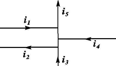

Calculate the current i5 in the configuration. Use the following data: i1=8.65 A, i2=5 A, i3=7.85 A, and i4=8.5 A.
Kirchoff's junction rule states that the sum of the currents meeting at a junction has to equal zero.
According to the junction rule, i1+i2+i4=i3+i5. When I plugged in the numbers, I got i5=14.3 A but my homework says that is wrong. Does the direction of the arrows affect the outcome or am I overthinking it at this point?

It is better to either add up the currents leaving a node, or add up the currents entering a node. I personally like to add the currents leaving a node and set that sum equal to zero. So yes, the arrow directions definitely do make a difference. Since I like to add up the currents leaving a node, I would use a + sign on all of the currents in the figure that are leaving the node, and a - sign on the currents that are entering the node. The sum of thoses currents (with either a + or - sign in front of each) has to equal zero.

Entering the node: i1, i4, and i3? i3 and i5 confuse me. When I add up the total, I get -i1+i2-i3-i4=-20. So i5 would have to be 20 for the total to equal zero. I feel like I am still missing something here.

That is all correct, IMO. So you write the equation like this:
-i1+i2-i3-i4+i5=0
And solve for i5. That gives you the answer you mention. Is it correct?

Thanks so much guys! 20 was correct and I understand why. :)
