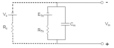

Using Kirchov’s Current Law (KCL) at the top node of the circuit, write the differential equation for the membrane voltage (Vm). Solve for Vm(t) symbolically,assuming that all other voltages, all resistances, and the capacitance are constant
Current law (sum of currents at a node equals 0)
I think after i set it up i would be able to solve the differential equation. What I have is:
Cm dVm/dt + (Vm-Eth)/Rth + (vm-Vc)/Rc = 0.
Let me know if I am on the right track

Hi Alex. Yes, your work looks fine; You're on the right track.

I'm finding that the circuit definitions are a bit odd. For example, the two sources are shown with their negative terminals upwards and their specified potential differences are given as negative values. So really they are sources that are positive on top? Is this just meant to add confusion or is there some physical reason why the circuit is modeled in this way? Also Vm is defined on the diagram to be the potential at the bottom node with respect to the top node, yet you're asked to use the top node for writing the node equation. I'm wondering if there's a point to all this? What is the significance of the dashed lines for the Vc branch? Is this branch only connected at t = 0? This would have implications for the initial conditions of the circuit.
I too was confused on why all of the given voltages were negative. If it helps, there was a bit of information at the top of the page:
You are conducting a voltage clamp experiment on a cell in which all of the gated channels have been inactivated. The circuit model of the cell membrane and voltage clamp is given below, as well as the data of the membrane voltage measured over time
I think that it is okay that Vm is the difference between the top and bottom node. You can still use the top node to find Vm (because Vm shows up in the differential equation). Also, the dashed lines can be read as a solid line. The professor mentioned that he made them dashed lines just to show it's the voltage clamp and not the cell, but functionally it is a solid line. The branch is connected for all t.

Going back to your differential equation solution, I think you need to revisit it. The units don't look right:
Alex Katko said:
Finishing some algebra, i get: Vm = (Rth + Rc)((Eth/Rth) + (Vc/Rc)) + Cexp(-((1/CmRth)+(1/cmRc))t)
Note that if C is a capacitance then you are equating volts to farads.
C was the constant that came out of my integration. I actually solved for C with the initial value V(0) = -64.3
C = -64.3 - (Rth+Rc)((Eth/Rth)+(Vc/Rc))
But the question asked me for what Vm is as t approaches infinity. So solving for C wasn't really necessary here because I believe that term should just go to 0

Alright. Looks like output voltage readings taken from the moment that the "clamp" is applied.
Getting back to determining Rth then, my first instinct would be to use the steady state conditions to find it, bypassing the differential equation entirely. Remove the capacitor (since at steady state its current will be zero) and find an expression for the output voltage. Equate it to the given Vm for t = 1000s. You should not run into any square roots doing it this way.
I thought of doing something like this, but i felt the instructions sortof implied i was supposed to use the solved differential equation to find this. And if my solution to the equation is correct, then it should give me the right value for Rth. Assuming the equation is correct, am i right to say that the exponential term would drop off, leaving only Vm = (Rth + Rc)((Eth/Rth) + (Vc/Rc))? If so, solving for Rth gives imaginary values, witch means my solution is incorrect. Part A (solving for Vm at any time t) was worth almost all of the credit, so i am trying to focus my efforts in seeing what i did wrong.
