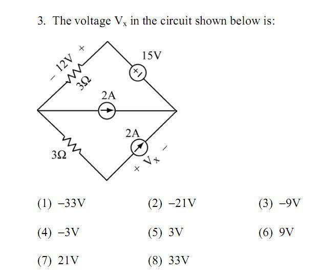

KVL, the sum of all voltages around a loop equal 0
Vx is just the difference of the bottom node to the right node. With KVL I just add up the the voltage differences in a loop and equal to zero right? -15+12+6+Vx=0 Vx = -3 ... However my professor posted the answer and Vx = -9 ... why is that? what am I doing wrong?

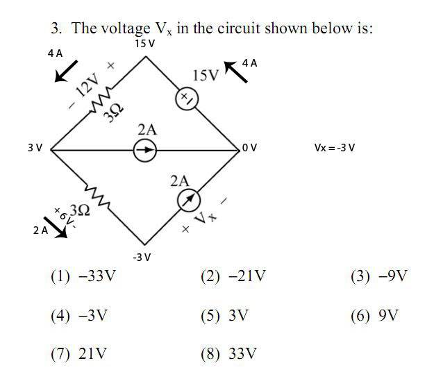

If you know how to use node analysis you can get the answer more quickly and easily.
Establish a node as ground and the voltage at the node you want to solve you just sum the currents into that node to zero.
Establishing the right node as ground:
node analysis equation:
(3-Vx)/3 - 2 = 0
Which solves for Vx = -3
I actually ended up with the same answer as you, perhaps you should ask your professor if it's a typo?
I could've solved it incorrectly as well though.
Your solution is correct. Your professor made a mistake.
thanks for the help! i just got an email and it was a typo and the answer is -3
