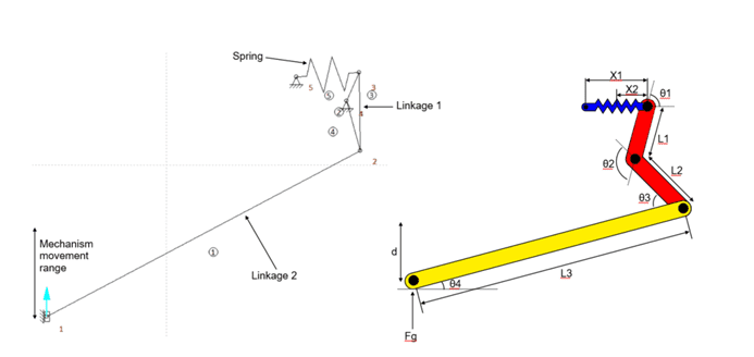

Summary:: I am making a landing gear mechanism, and am struggling to mathematically model it, the aim is to find the required properties for the spring for it to work.

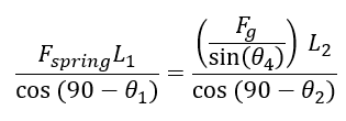

Hi can you help me with a problem, I am making a landing gear mechanism and am struggling to model it mathematically. The aim is to find the required properties for the spring, for it to work. The approach is based on the conservation of energy, and the frictional losses are assumed to be zero.
k - spring constant
X1 – initial spring length
X2 – Final spring length
W – work done
d – travel distance
L1, L2, L3 – constant length
Θ2 – constant
Θ1, θ3, θ4 – variable
Fg – force due to gravity

Since linkage 1 is balanced, the moments are equal to each other
Adjusting for forces that aren’t acting tangential to the members of linkage 1.
FL2L3 is the force acting linearly to the length of linkage 2
2.2 Adjusting for angled force
Finding relation between FL2L3 and Fg
Inserting the relation into the equation, we have
Rearranging
I don't know what to do from this point on, can you help with
1. Generally solving it?
2. How do you express all angles in terms of θ4?
Any help would be appreciated, thank you

Where is the tire located at?
What does guide #1 to move vertically up and down?

Again, what does guide point #1 to move vertically up and down?
Shouldn't x2 be represented on the other end of the spring?
Why is force due to gravity decreasing?
Where da and db are located at?
It is very important to determine the spatial geometry of point #1 (and its range of free movement) respect to point #2.

1. it can only move along the y-axis (up and down)
2. your right, that's what I meant
3. that is another mistake, fixed it
4. da and db are meaningless lengths there just showing that the moment is balanced, I thought it was a bit of a leap so added that step

  • First, you got ##F_b## in terms of ##\theta_2##, how is that even possible?
  • Second, the relationship between ##F_{L_2 L_3}## - whatever it represents - and ##F_g## is most likely wrong.
  • Third, I'm not sure why you need to analyze spring work at this point.
What you need to do is free body diagrams (FBD): one for linkage 1 and another one for linkage 2. You will have to assume that you have horizontal reactions on both:
  • One on the slider connected to linkage 2;
  • Another one on the center pin of linkage 1. There will also be a vertical force component on that pin.
To help you, instead of using ##\theta_3## as the angle between both linkages, define it as the angle between ##L_2## and the horizontal.
Although irrelevant for your free body diagram, note that the spring may be preloaded at a certain value of ##\theta_1##. As long as ##F_g## does not counterbalance that preload force ##F_p##, the mechanism will not move. (i.e. the pre-compressed spring is like a solid link). So once you find the force ##F_s## from linkage 1 acting on the spring - with your FBDs -, you can get the spring displacement between the final angle ##\theta_{1f}## and the initial angle ##\theta_{1i}## with (assuming the spring stays horizontal):
$$K L_1 (\cos \theta_{1i} - \cos \theta_{1f} ) = F_s - \min(F_s; F_{p\ @\theta_{1i}})$$
Where ##K## is the spring constant.
Once you have solved the FBDs, define ##L_x## as the horizontal distance between the slider and the center pin of linkage 1. Everything should come easy after that with simple geometry.
