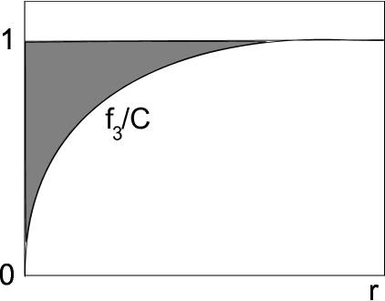

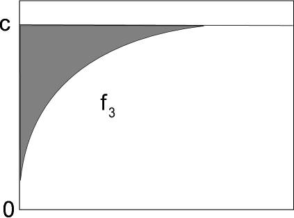

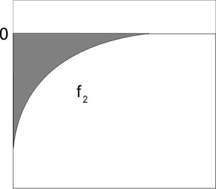

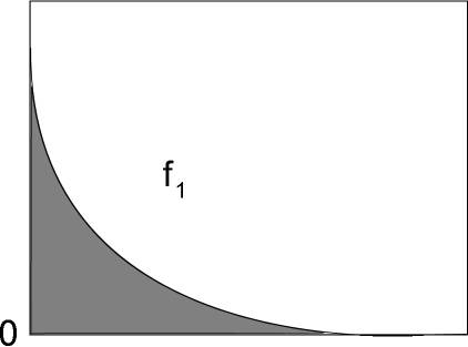

I am researching a hypothesis and looking for anyone who is familiar with differential topology (specifically Einstein manifolds). I have access to the Besse book Einstein Manifolds but am also looking for any open questions in differential topology that I am not aware of. I am attempting to develop a solid proof link between the Laplacian and Einstein manifolds (listed in the book as not found yet, free meal up for grabs!). I have seen somewhere that there is a discrepancy concerning the physical representation of Minkowski space, but there were no details listed and can't find the reference anymore. If anyone happens to know a paper detailing this it would be appreciated.
The math is pretty basic, sort of a gauge theory of the Laplacian. In graphical form (as the equations might be confusing without them). So whether function goes to all zero scalars or some arbitrary scalar values will give the same Laplacian [itex]\nabla^2(C-f)=\nabla^2\Phi=0[/itex]
Attempting to equate this to [itex]4\Lambda-R=0[/itex]

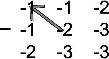

If we flip the integrable function f about the x axis, there is no distinction between the derivatives of the following plots:
so for two dimensional gradients easier to see:
It's not possible to say anything meaningful without defining the quantities you're using. You have some harmonic functions [itex]f,\Phi[/itex]. Are they somehow related to the metric on some manifold? Perhaps whatever you have in mind could be compared with the situation of Kaehler manifolds, where the metric is actually determined by a scalar function (locally in general, globally if the manifold is also complex).

but the gradient of [itex]\Phi[/itex] isn't unique, since we could just as easily "flip the integral over" and use a scalar function that decreases from some value [itex]\frac{d(C-f_3)}{dx}=\frac{d\Phi}{dx}[/itex]:

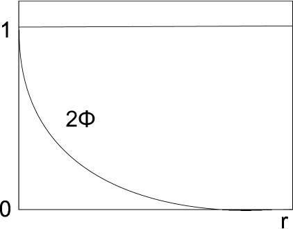

What interests me is comparing the weak field approximation [itex]1-2\Phi[/itex] to a normalized version of the decreasing scalar function:
I am trying to determine if I can link a scalar constant with a constant multiple of the metric. Approximating the last plot with the 00 component of a normalized Einstein manifold [itex]R/\Lambda=g[/itex].

It would be something like
[tex]R=\Lambda g_{ab}[/tex]
[tex]\frac{R}{\Lambda}=g_{ab}=diag(1,-1,-1,-1)[/tex]
[tex]g_{ab}-\frac{R}{\Lambda}=diag(1-1,-1+1,-1+1,-1+1)=\delta_{ab}-h_{ab}[/tex]
[tex]\lim_{r\rightarrow\infty} h_{00} \rightarrow \frac{R_{00}}{\Lambda_{00}}=\frac{f_3}{C}=1[/tex]
[tex]\lim_{r\rightarrow 0} h_{00} \rightarrow \frac{R_{00}}{\Lambda_{00}}=\frac{f_3}{C}=0[/tex]

You should probably be consistent with indices if you're going to use them. I realize that most of Besse is written with index-free notation, but you can't have one side of the equation be index free if you're using indices on the other side.
If [itex]g_{ab}=\text{diag}(1,-1,-1,-1)[/itex], then [itex]R_{ab}=0[/itex]. This is a flat Minkowski metric. It is still technically Einstein with [itex]\Lambda=0[/itex].
Given the flat metric, this equation is ill-defined. Even if we just had
[tex]0=\text{diag}(1-1,-1+1,-1+1,-1+1)=\delta_{ab}-h_{ab},[/tex]
then it just means that [itex]h_{ab}=\delta_{ab}[/itex], which would be another constant, flat metric.
These are inconsistent with [itex]h_{ab}[/itex] being a constant. Also, your problem with indices has turned up, since [itex]\Lambda[/itex] is a scalar, so it has no indices.
Anyway, looking back at your graphs, you seem to want a source-free solution to the Einstein equations that is an increasing function of the radius. This is impossible, as the vacuum equations admit the Schwarzschild solution as the only spherically symmetric solution. Technically this is due to Birkoff's theorem, but on physical grounds it is the statement that the Newtonian potential must decrease as we move away from a point-mass at the origin.

I do understand about Birkhoff's Theorem, but it is curious to me that the Laplacian/Poisson can handle this. I wonder why the field equations can't be written such that a spherical Schwarzschild solution works for either a positive mass density, a negative mass density, or even an energy density that decreases from something like a QFT value. I don't understand why the symmetry would break down. Why would differential topology care about absolute energy levels and not just the derivatives?
I had assumed from [tex]g_{ab} = \delta_{ab} + h_{ab},~~~~\lim_{r\rightarrow\infty} h_{ab} \rightarrow \frac{C}{r}.[/tex] that you were considering [tex]h_{ab}[/tex] as a perturbation and not as a constant.

If [itex]R_{ab}=0[/itex], then [itex]R = g^{ab} R_{ab} =0[/itex], so [itex]\Lambda=0[/itex]. In your last equation you are trying to divide by zero.
Well you now seem to be including a cosmological constant, so that changes the solutions slightly. With a cosmological constant [itex]\Lambda[/itex] and vanishing stress tensor, we have the de Sitter-Schwarzschild solution (in your signature)
[tex]g = \text{diag} (f(r), - 1/f(r) , r^2, r^2\sin^2\theta),[/tex]
[tex] f(r) = 1 - \frac{r_s}{r} - \frac{\Lambda r^2}{3}.[/tex]
For [itex]\Lambda>0[/itex], the corresponding potential does begin to increase at large enough r, where the effect of the CC dominates the source at the origin. This space has positive curvature asymptotically. For [itex]\Lambda=0[/itex], we have the ordinary Schwarzschild black hole. For [itex]\Lambda<0[/itex], we call it anti-de Sitter-Schwarzschild and the space is asymptotically negatively curved.
Birkoff's theorems tell us that these are the only solutions and that they are static. Our source has delta function support at the origin (because the stress tensor is zero), and the parameter [itex]r_s[/itex] is a constant (by Birkoff). Physical considerations like the weak energy condition would suggest that [itex]r_s<0[/itex] is unphysical, but there's no mathematical reason not to consider the possiblity.
