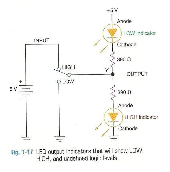

I know that only low will light when the switch is low, and high etc..., but I don't know WHY. People have tried explaining it to me but I don't understand. I've been staring at it all day to try and figure it out on my own, tell me if this reasoning is right.
When the switch is high, the electricity has 2 paths it could possibly flow. Up around towards the low indicator, and then through the switch to the high LED. The up around would require it going through a total of 4 resistive elements, then switch 2 elements. So it takes the path of least resistance and takes the switch path first. This puts Y as +5v so now the electricity can't flow through the LOW indicator because there is no potential different +5v on both sides..
That's the only reasoning I can think of why it doesn't take both paths...
With the switch on HIGH, what will be the voltage at OUTPUT? How much voltage will be across the LOW indicator? How much voltage will be across the HIGH indicator?
Ohm's Law is the key to understanding these circuits. [ E = I * R ] How would you apply it to the above circuit?
V = IR, 5v / 780 ohms = ~6 milliamps. That's all I know :(
In your circuit you show 5V connected to the bottom of the upper 390 ohm resistor. How much voltage would you say is across that resistor?
i think..when the switch is high the current will flow through high indicator because at junction"y" it is five volt and above it is also 5 volt so the low indicator LED will be reverse biased and hence will not conduct and so the current will pass thru high indicator and it will glow.
and when the switch is low the left side supply is isolated and the current will flow from the above voltage supply to low indicator led and then to the ground via the switch.current will not go through high indicator because it high resistive path.
i think it is clear now.
