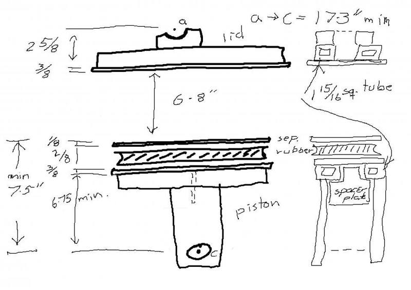

At this point I'm not overly worried about the forces as I have some very heavy machinery parts to scavenge. It would be nice to have some input about shaft shear. Is it right to think that the 100 tons would be shared by the two rests that the shaft sits on ie. 50 tons each?
ATM I'm looking at a 1 1/4 inch polished round bar off a railcar wheel assembly and the 1 1/4 inch x 2 1/2 inch section swivel arm it is mounted on which is pre-drilled for the axle. Likewise I can cut one of those rectangular arms in half and get the half round rests to put on the lid.
This is a major upgrade from what I've been building so far but looks like it's worth it. (I haven't seen a version of this press this massive before. I have seen bent ones.)
Another thing to consider is the thickness of the walls of the box the piston slides up and down in.
Off hand I haven't thought it's much to worry about as I don't expect much lateral force on it from the compressed soil. There will be ample clearances for water to pass through.

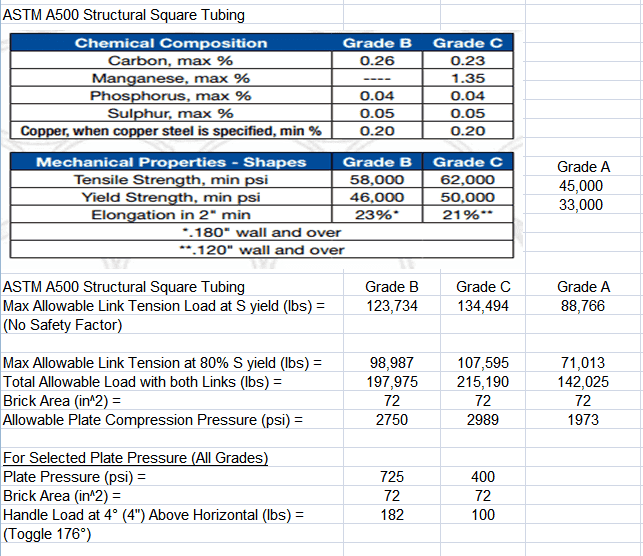

The principal loads will be carried by the linkage pivot shafts, the AB arm and the two BC links. Particular attention needs to be given to the tension stress on the BC link areas on each side of its holes and shearing stress between those holes and end of the link. At the highest load point, the short AB arm will be principally in compression so the bearing stress of the shafts on its holes will be the major concern for that arm. As you have seen, there can be very high bearing stresses between the shafts and their hole surfaces so they will be of the most concern as points of wear and possible galling if the shafts are not surface hardened; and, hardened inserts for the linkage holes would be also be a good idea for reducing hole wear and friction and extending the operating life of those critical areas.
Edit; Ref letters correction also error on excel calculation sheet: I just discovered I used the wrong ref cell for getting the pressure load.
I used the area x 20 MPa when I should have used the area x 2900 psi (dumb error) Sorry.
See corrected Excel program and graph on below Post.

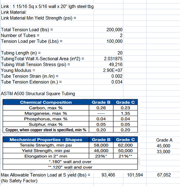

Corrected Excel Program and Sample Graph.

One thing that you need for design that I have not provided to you so far is a graph of the increase of forces on the machine as the handle rotates; but, the minimum force on the all of the pivot pins and on their mountings to achieve your desired 20 MPa pressure on a 6" x 12" brick is equal to the Fc = 208,800 lbs shown upon the sheet.
Unfortunately, that 208,800 lb force is not the maximum force the that the linkage can apply when fully aligned, that force is only limited by yielding at the highest stress point(s) in the machine assembly and and this where the rubber pad becomes important, by including that pad (if sufficiently thick), as I think you already understand, it can act as that weakest yielding member rather than one of your machines parts.
The thing that makes a toggle assembly so dangerous to the machine is the fact that as the toggle begins to reach it s full alignment, the amount of force that the operator has to apply to the handle reduces to essentially zero (as shown on my graph) so the operator doesn't have any real sense that the machine load is increasing to the point that something in the machine has to yield.
Just as a note at this point, I don't know how much education or experience you have with stress analysis calculations but as things move along I ( and I believe other forum members) will be glad to give you some assistance in that process.

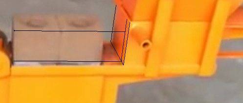

  • #52
a screencap from the posted vid appears to confirm about 30% compression.
Comparing loaded soil height to compressed brick :

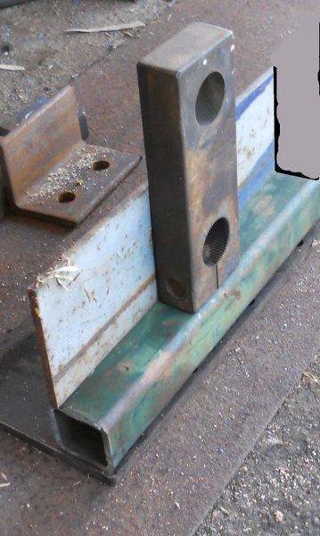

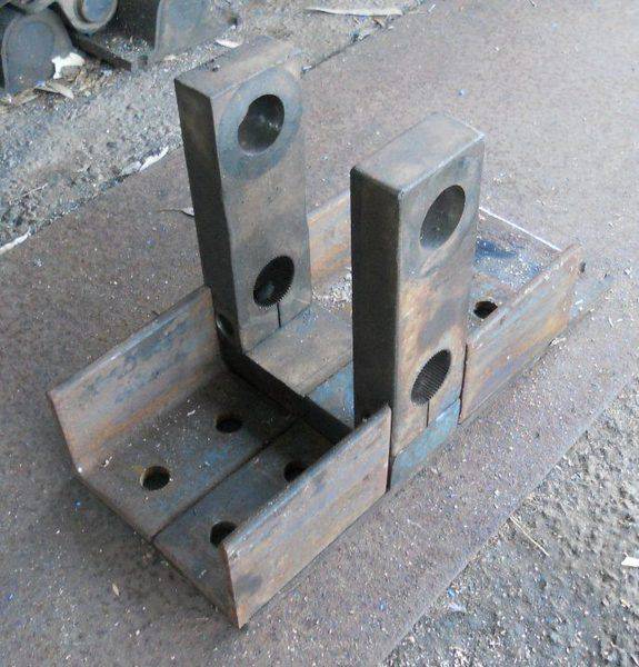

I'm getting close to finishing the 'knuckle'. Before welding it all up I'll post a pic with measurements and description with the hope of getting comments.
  • #57

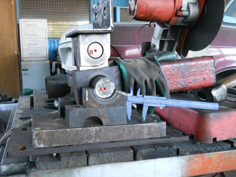

Not welded yet:
AB = 3", for scaling: caliper set to 1", hammer 3lb, glove covers ugly grind job, the long lever is inserted in the red rectangular box, the short angle iron represents crosspiece.
turns out the axle 'guides' have hardened inserts. I cut one guide in half and use it as rests. Everything below that is just a 'sketch' for now.
  • #58
I'm a bit concerned about the combined smaller apparent 1 1/4" diameter shaft and narrower side plates for the B shaft because that pivot has to carry the same 200,000 lbs maximum load as the handle's A shaft with a larger shaft diameter and wider hardened half bushings.
  • #59
Ok, the reason for the larger shaft and plate is that I have a stack of these 'railcar' hydraulic machines but only one of the wider pair found, unfortunate, I understand the weak link here is the 1 1/4" shaft and 1" plate.
How concerned are you? (afk for 8hrs)
  • #60
One concern is that the shearing load the shaft is 210,000 lbs and that does not even include any safety factor.
As an comparison, the allowable double shear load rating of a high strength 1 1/4" SAE Grade 8 A490 steel bolt is 221,000 lbs; so, to be safe your shaft material should have a tensile strength equal to or greater than that of quenched and tempered A490 Alloy steel.
Since you are using an axle shaft, I would expect it to be a heat treated alloy bar, so if you are unable to determine the material of the axle shaft, you may just have to take the "try it and see" route. The risk is that, because it is an axle shaft it may hardened to the point of being a brittle material that will suddenly break rather than just deform as a more malleable quenched and tempered alloy would do.
Apart from the above, with respect to the small shaft and holes, due to their small contact areas, I am mainly concerned about possible lubricant displacement and galling in the segment of the shaft and hole that will be repeatedly exposed to a very high load in the region of the maximum load at the end of each pressing stroke. Unfortunately, I cannot find any reliable reference as to what an acceptable contact pressure should be.
Note: Edited for more clarity

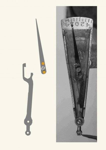

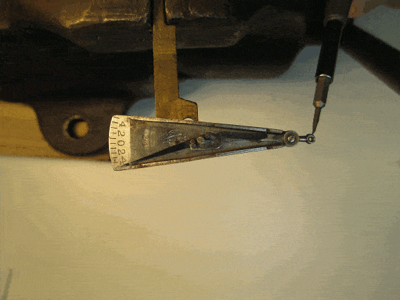

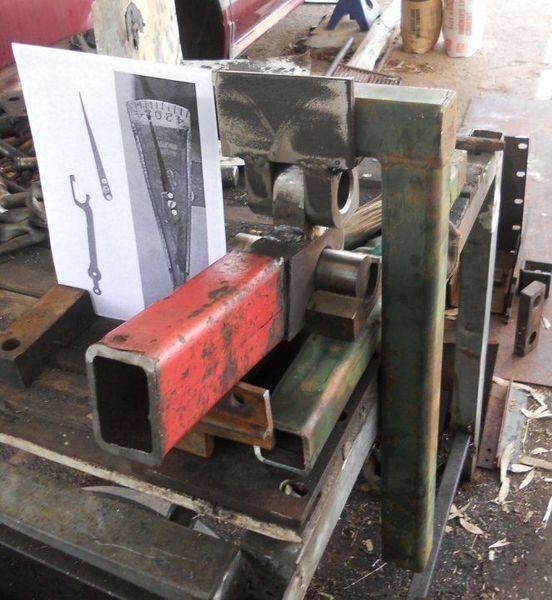

current progress.
as a possible guide I'm thinking of making an Ideal indicator :
to gauge angle C as it approaches 0 by mounting it on the side of the case with a feeler on the U arm actuating it so I can see the readout while pushing down.
  • #68
With regard to your post comment about reaching the required loading, there is going to be a bit of a fine line there and the most difficult will be identifying if there has been enough fill to reach the lower pressure limit (you are going to be having a certain degree of variation in your finished pressed brick pressure) because this will be based upon the operator feel toward the end of the stroke. In the case of an overfill, the maximum compression pressure for those bricks is going to be limited somewhat by amount of loading the operator can apply to the handle to achieve a full stroke.
  • #69
Yes. I'll take care in designing the depth of the chamber and have a way of adjusting that. Loading the same amount every time shouldn't be a problem. Assuring soil mixes are consistent, batch to batch, might be a bit difficult.
I'm thinking of fixing the rubber mat to the underside of the lid.
The 'Ideal' dial, if placed properly, should give a precise reading of angle in approaching 'top dead center', and if knowing through the calculations at what angle the best pressure is reached it should be helpful.
  • #70
The rubber mat may need a metal plate separating it from the soil mix to prevent high contact pressure embedding and bonding between the brick surface and the rubber.
