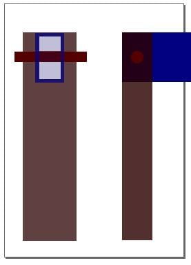

Since this is the piston, on the first design, how are you planning to guide it to keep the piston face horizontal in the box?
Is that what the side plates in this last design are intended to do; or, are you planning on using the side slots for controlling it?
At this point, my main calculations are focused on supporting the horizon pressing face plate so that it will be rigid enough to deal with the high compressing pressure; and, in that respect, my calculations show that the face plate should be at the very minimum 1/2" thick (this can be by adding a 6 x12 x 1/4" thick plate on the bottom pf the existing structure.
On your latest design, since you are using the 2 x 2 sq tubing if you insert a third 2x2 sq tube between your current two side tubes to make that part of the structure into an essentially reinforced box and with the added 6x12 3/8" bottom face plate.that would would a really good rigid assembly for resisting the compressing pressure without deflecting so if you can do that, I think your last above design with that third tube added would make a really strong piston. I was intending to ask you add some side gussets to reinforce the first design but the vertical plates on the last design will serve that function.
  • #108
The idea is that all edges are flush with the 'case', the two c points are apart only by the thickness of the case walls and that this provides sufficient guide for the piston.
Adding the strengthenings you advise is no problem.

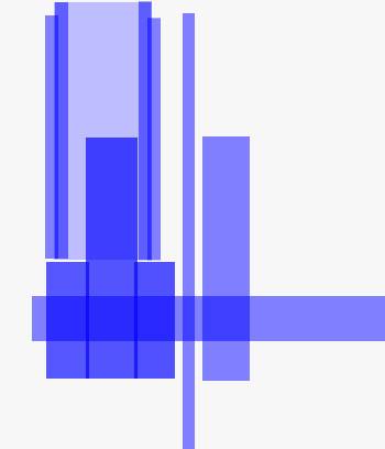

  • #114
What about instead of a centre tube I add spacer like indicated here in grey.
spanning between the two upright plates (only one shown here) ?
(I've also added the rubber and spacer plate.)

  • #117
Edit:
Update on the piston. and box
I have analyzed the stress on the walls assuming the .57 transverse load factor is correct and I have found that, based upon the 12" long side, a 1" thick mild steel plate material should work; for all sides, but nothing thinner than that and be sure to use heavy welds at the corners. The top 6" of the box in the high pressure area is all that really requires that thick of a plate, so a thinner plate can be used for the lower box section, doing that in the piston travel area will require welding the top and bottom section together with a perfectly flat inside face on the joint; but, below that point there isn't any real joining issue and you may want to do that to make the box lighter and the cutting of the the piston rod slots easier.
Since you have already assembled the piston to this point, adding the third center tube is probably not an option because for that to work the three tubes have to be in full side to side contact with welds along the top and bottom joint lines to provide the reinforcement I was looking for.
I think the spacer alternative you have suggested will work; but, I may want you to add similar spacers between the ends of the two tubes as well. Once you give me the the piston frame top plate thickness then I will have a better idea of what i think is needed.

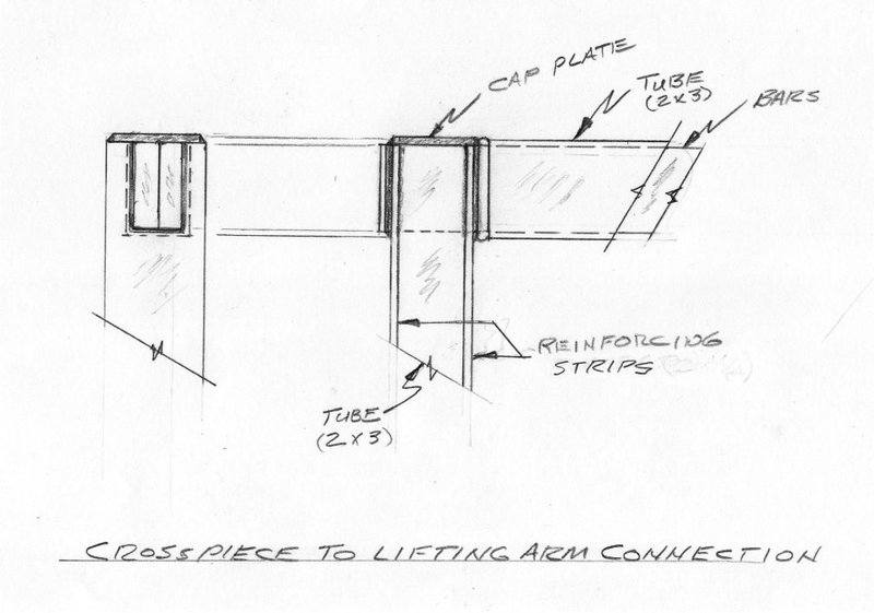

The Piston so far. Spot welded. I added a couple of spacers that helped in construction but are also useful re strength.
  • #124
Your new design looks really good and the spacers are really critical in holding the two arms aligned and adding transverse rigidity to the piston structure. You just were one step ahead of me with the spacers, the only reason I opened this thread this morning was to suggest to you that, even though we had added the third tube, adding the spacer you had suggested would be a good idea.
Most designs are a progressive process and that is why your sending me your update pictures is really a help in my being able to visualize where revisions and/or additions might be needed.
With respect to my stress analysis on these parts, it is a combination of calculation and judgement, because composite structures like you are building are very hard to fully accurately analyse using basic equations. As a result, as we go along in some cases, I will suggest something that I know will add strength and rigidity to the structure but that I cannot exactly calculate amount of benefit, so if I see something of that type and it is reasonable to add it then I tend to recommend doing so.
For me, a big part of what guides me is that, even though your machine is manual and relatively small it is working with very high loads. To put that in perspective, a 50 ton cargo capacity railway boxcar weighs approximately 250,000 lbs and even at the reduced 2550 psi compressing pressure, the load on your links and axles, etc is 183,000 lbs. So in effect you are making parts that should be able to safely lift 3/4 of that boxcar, including its wheel sets.

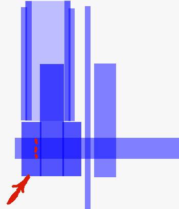

One thing that concerns me is c.
The thicker the walls are the further apart the piston arms and the arms pulling the piston up are. This really can be a problem I think. ?
  • #126
According to a calculation I have run with a 1 1/4" dia shaft indicates that anything more than 1/4" space between the piston arm outer face and its adjacent pulling arm face is going to b e a potential problem. One solution to this would be to use 1/4" plate for the body below the pressure area and make its inside flush with the inside of the 1" plates and then make the pulling arm bottom shaft mounting blocks extend the 3/4" into the outer faces of that lower section of the box.
Do you have any alternative thoughts?
PS You have not shown me your design for the shaft connections on the bottom of the pull bars.

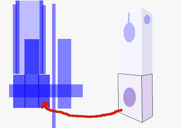

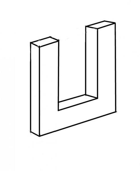

One alternative thought that is just thinking outside the box that may jog some other ideas. : A walled insert that sits on top of the piston.
I haven't finished designing the U arm except as far as we've talked about already. I won't start making it until the box is made.
I have thought about thickening the bottom part as you suggest but then it may interfere with the block ejection stroke y.
here's a sketch of that part with some naming.

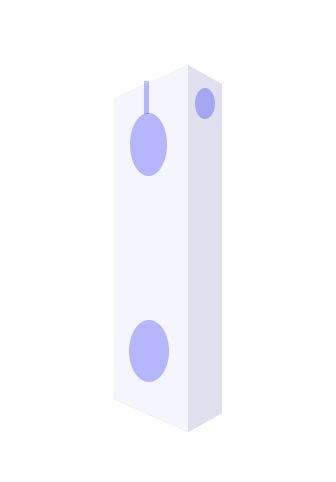

  • #128
another idea I have is a shaft that goes right through from side to side.

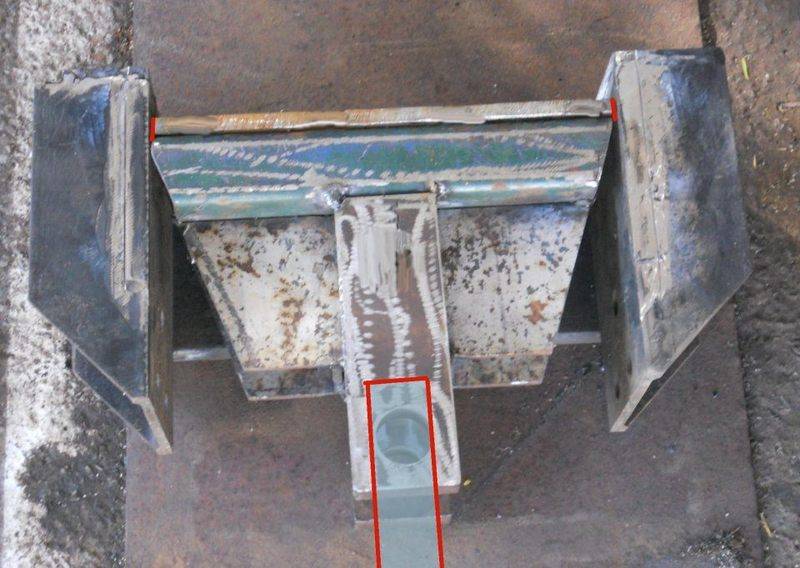

I had already assumed that there would be one shaft would be going all the way across, using shaft stubs as shown is a bad idea because they do not give added strength and rigidity to keep the shaft straight in the bearings.
I don't see how you could add the walls onto the piston without creating a pressing problem or having to add a rather deep spacer between the top plate and the fill chamber and when you lifted the brick it would still be buried deep in that chamber.
I assume you are aware that you must add substantial blocks for the shaft connections to the bottom of your square lifting tubes;and, if the current piston arms are not long enough to accommodate say 1/2" of that block above the shaft and allow fully lifting the brick clear of the top of the pressing chamber then that can be compensated by adding a filler on top of the piston plate.
I understand your problem with getting the 1" material so there are a couple of possible solutions for laminating plates to the get the effective 1" sides. Is there any chance you can get some 1/2" plate; because the thicker the laminate plates and the fewer of them the better.
Since we are assuming you are using A36 mild steel plate, even at 1" thick the stress level is right at the specified min yield point of the material, so by even allowing that plate thickness I am counting on the material being actually stronger than that (which is generally the case) and the possibility that the transverse pressure of the bricks will be less than that indicated by what references I could locate.
It is a shame that we do not have any specifications for your material because 1018 plate is also classified as a mild steel but has a 50% greater strength than A36; but we have to use the lowest expected strength as a basis without any knowledge of thee material alloy. (Note: Even with 1018, 7/8" of thickness is required).
Although we have little information on the strength of the sq tubing, that element on the pull bars worries me the least because if overloaded those bars will just stretch and with a 15% elongation to break their limits will be easily identified before any failure and they are the easiest to reinforce by adding side strips.
On the other hand, I see the body as a more critical element because, while I am not concerned about failure, if the sides of that box bow outward during pressing then there is little that can be done to correct that problem once the box is built, other than to simply reduce your target pressing pressure even more to the the point that the existing box sides will handle the load.

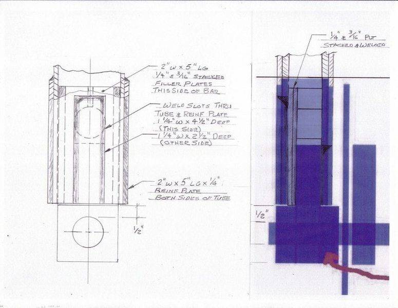

  • #131
Ok. 1" it is.
I have a lot of 3/8" and 1/4". I'll keep looking for 1" plate though.
I understand what you say re add blocks. I think that can be done easily re 1/2 inch above shaft.
I have found a shaft long enough to go all the way.
I think it's a good idea to assume weak material.
Ok, apart from getting a hold of some 1" plate, I'm happy.

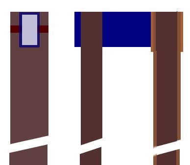

  • #132
Does the added on part introduce some torsional force on the lift arm that should be considered.
Is the (light coloured) part above the shaft necessary as the arm is lifting only.
  • #133
The top does not contribute to the support of the shaft and the support could be a "U' shaped part but the added height and top weld will increase the strength of the parts attachment to the bottom of the arm.
The added width will not increase the torque on the arm if lubricated because friction drag is a function only of force not area (although that may be hard to accept since it is counter intuitive). On the other hand, the added contact area will reduce the pressure on the lubricant.
The greatest problem for the shafts is any bending they experience because that will create high contact loads at edges to the shaft holes.

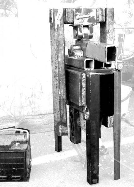

I lined up parts to get an idea of how things are. Some parts are obviously not there and others not made yet but it gives the idea.
  • #138
From your picture, it appears that once the side plates are added then the supporting stand and pivot for your top plate are about al that remains for the main structure.
Truthfully, in looking at your pictures with nothing else to compare to for size, the machine appears much larger than it really is when I realize the pressing cavity is only 6" by 12". (about the same size as the keyboard section on my laptop computer)
  • #139
yeah, I should have put a matchbox or something regular in the pic for visual que. Still, it's got a massive presence in real life. I dub it 'ye ole' nut cracker'.
