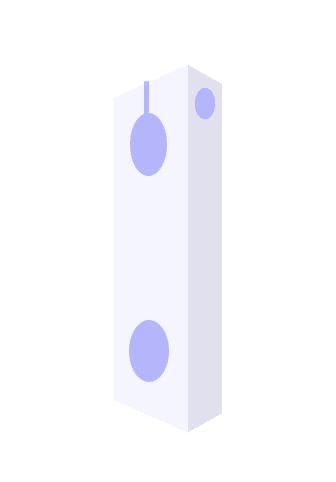

I have a number of the 1" which are actually 1 3/16 x 2 9/16 x 7 3/4 " that fit very nicely in the 2x3 tube. they are all pre-drilled for the shaft so I need to use them. Then I have 1/4", 3/16" plate.
I think I have found a possible solution for connecting the tubing to the axle bar using your available materials, but, I need to know the distance between the inside edges of the two holes in the 7 3/4 long axle bar(s) and the length from the the inside edge of the axle hole to the opposite end of the bar.

This is a drawing of the bar.
The lower hole is where the axle goes (c).
The upper hole is serrated and gripped on to a serrated torsion bar suspension on the 'rail car' by clamping it on with a bolt through the small hole.
Can you describe in more detail which dimensions you are after?
note. after writing the above I reread your post and I think you mean between the two bars in the two arms. ?
Using your above figure as reference, I am asking for the distance from the top edge of the bottom hole to the bottom edge of the top hole; and also, the distance from the top edge of the bottom hole to the top end of the bar.

the distance from the top edge of the bottom hole to the bottom edge of the top hole is 3 3/16".
the distance from the top edge of the bottom hole to the top end of the bar is 5 1/2".
Attached is a suggested bottom connection design. The stacked 1/4" & 3/16" strips welded to the outside face of the axle bar are there to bring that to the 1 5/8" thickness required for a close side to side fit inside the 3 x 2 tubing for a strong welding attachment from the tube to the bar. I would have placed the 1/4" plate on one side of the bar and the 3/16' plate on the other but that will affect the inside 1" spacer clearance between the bar and body of the unit. Unfortunately, the top hole in the bar forced me to shorten the weld slot on the bar side without the added spacers.
