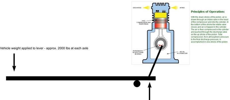

If I have a 10 foot long lever and the fulcrum is 1 foot from the end, if I place 2000 lbs. of force on the lever, what will be my "force" or torque at the end of the lever? And, very important, how much distance will the tip of the short end of the lever move up if the long end of the lever can only go down 1" at its end?
Also, can I somehow translate the torque developed at the end of the lever into a horse-power calculation? Say I'm driving a crankshaft or piston into a cylinder (air-compressor) at the short end of the lever. What kind of HP and CFM can I generate?

OK. I have a "lever", a 10 ft long piece of steel. It will be placed horizontally level with a "fulcrum" 1 or 2 ft from one end. 2000 lbs of kinetic energy (a vehicle) will roll over the other end of the lever thus applying the force. I want the lever to drive a crankshaft or piston into a cylinder and compress air. The "long" end of the lever cannot depress more than 1".
If I can determine the foot pounds of pressure I can develop at the short end of the lever I can likely calculate the HP equivalency I will have to drive a piston.
You are still not clear on the setup. A diagram would help.

The car drives onto the "long" end and depresses it 1"? Well, if you apply 2000 lb of force over a distance of 1", that's 2000*1/12= 166.7 ft-lb of work (energy). If this happens in 1 second, you've applied 166.7/550 = 0.3 hp of power to the lever (for 1 second).
Note, the torque and power are equal on each side of the lever.

Simple diagram attached. Simply put: if a 4000 lb vehicle drives over a "bump" in the road, which in essence is a lever, and I have a fulcrum point 1 or 2 ft from the other end of the lever which, on its upward movement drives a crankshaft to an air compressor piston.

My calculation was correct then - though the time is irrelevant, it is actually the frequency of cars driving over that matters.

Although for the OP. I think this calculation is much to simple. Approximating the force of a moving vehicle riding over a lever requires a kinetic analysis. The force will not be static.
This is a good start however. Usually, it takes some practical application to convince people their calculations are far too simplistic and ideal.
There are soo many unanswered questions. Vehicle speed, suspension kinematics, tire inflation and specs, etc... these all will change the end result.

I guess I'm just looking for a Yay or Nay that I could move a crankshaft at the end of the lever with sufficient force to drive a piston and compress air. I have extensive uses for CA and solutions for compressed air storage and distribution systems. I'd like to aerate polluted bodies of water adjacent to a highway with the compressed air, for one example.
Yes you can do what you are thinking to do. But 'engineering' a design that you can correlate properly or predict the output can't be done with one simple formula. You can try to estimate possible power but it will be very inaccurate like I mentioned above. Even if all the factors are taken into account there will still be some error. If you really want to attempt this I suggest contact modeling using a dynamic simulator like MSC ADAMS. By "hand" this problem can also be attempted (then coded to solve) but it needs high expertise in the filed of multibody dynamics.
In short, your only problem in just trying it is designing the lever-crank interface properly.

It is just the ratio of the lengths of the two sides.
