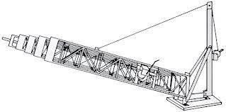

This seems simple but I am having trouble with this. I have 70' self supporting tower that I want to be able to raise and lower with a winch. The tower is hinged at the base.
I want to use rectangular steel tubing 7' high with a pulley at the top.
See PDF attachment. I need to know the force applied to the cable in order to get the correct size tubing.
View attachment lift force Model (1).pdf

Tapered or parallel tower, triangular or square section.
Lump the 400 pounds at the centre of the 70 foot tower.
That makes 400 pounds at 35 foot. I assume the base is 7 feet.
400 * (35 / 7) = 2000 pounds, or about one tonne.
With a pulley on the tower the cable tension will be halved to 1000 pounds.

aknisley: The theoretical, static tensile force applied to your cable shown in post 1 would be Ts = 12 580 N. But that assumes theoretical, very slow, perfectly smooth movement. No matter how carefully, and slowly, you move the system, realistically your cable tensile force will fluctuate. Therefore, the actual cable tensile force probably will be closer to T = 15 700 N. Therefore, use T, not Ts.
How is your vertical rectangular steel tube, shown on the right-hand side of your diagram in post 1, anchored? The cross-sectional size required for this tube would depend on how, and where, you anchor (or support) this tube.

aknisley: The tensile force applied to your cable shown in post 1 would be T = 12 580 N.
T=12,580 N = 5800 pounds.
Does the antenna have the structural integrity at one spot to support that load?

aknisley: Upon closer inspection, the tower CG is located at 40 % of the tower height, instead of 50 %. And if you move the tower very slowly, carefully, and very smoothly, then multiply the tower weight by a dynamic amplification factor of 1.25. Therefore, working this out gives an actual cable tensile force of T = 12 580 N (2830 lbf), instead of what I posted in post 16. Therefore, use T = 12 580 N.

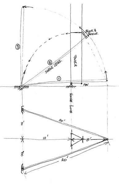

I really do not like using one 7' pole as the lever.
Without a crane, I would prefer to use two shear legs with a block and tackle, (B&T).
The shear legs could be 20' long steel pipe. The tower attachment would be at the 10' point where the lowest two sections meet. The shear legs would be seated 10' down range from the hinge line with the crotch about 6' up range of the tower. Raise the crotch of the shear legs to the tower using the B&T. Remove the remaining bolt from the free tower leg. Push the tower to tension the B&T. Then lower the tower by paying out the B&T. As the tower comes down the shear legs rise until they are vertical when the tower becomes horizontal. Fall the shear legs back to their starting position using the B&T or guy ropes. Raising the tower is exactly the opposite process.
The feet of the shear legs would be tied to the tower footing and to each other to prevent slip.

I am starting to get what you are saying. I pretty dense so could you do a sketch? What size pipe?
  • #35
Attached is a sketch showing shear legs and tower side elevation and plan.
The footings of the shear legs are about 16' apart.
The shear legs start in position 1.
They are then raised with the B&T to position 2.
The pin in the free leg of the tower is then removed.
The tower is then pulled gently down range, as it passes the balance point, weight is on B&T.
As the tower descends, the shear legs rise until they are standing vertical in position 3.
The tower is then horizontal.
Raising the tower is the opposite process.
Specification of the shear leg dimensions is a job for a real engineer.
Since they are quite long, the shear legs need to be designed with reference to column stability.
My first guess is that they would be a minimum of 4” diameter steel pipe with a 1/4” wall.
