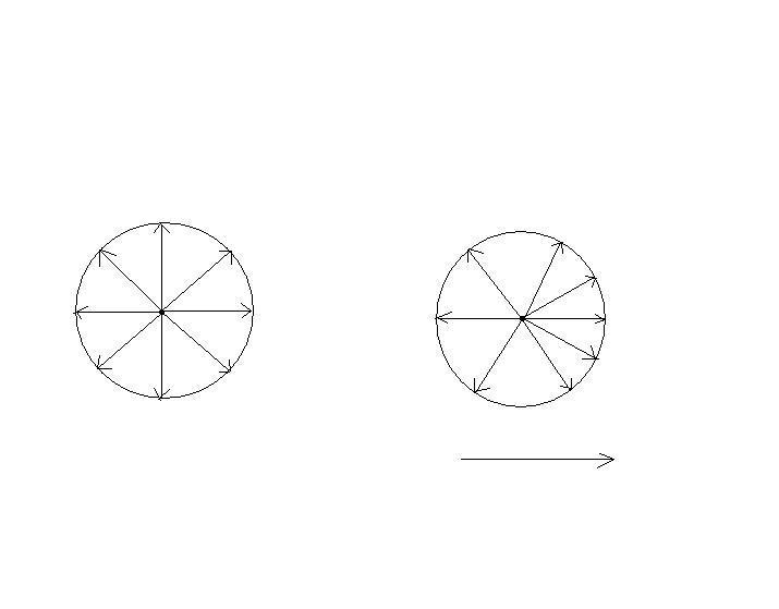

Ok, now we are with this. Please, look at below image.
If we think about spherical light source, then is above situation true?
Left circle shows source light vectors locally. And right circle shows source light vectors while source is moving right relative to an observer.

Yes, it's called the headlight or relativistic beaming effect. :tongue2:

So, intensity will be increased in front of light source and will be decreased in back of light source. Right?

Right.

Ok, If there are two intensity detector at front of light source and end of light source in light source's frame. And same two detector in observer's frame.
Will the source's detectors measure equal intensity? And observer's detectors measure unequal intensity?

Yes.
