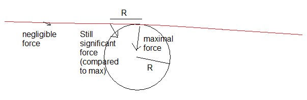

The length of the path where the gravitational acceleration is close to (or at least not far below) gsun depends on the diameter.

Does this help?

Thanks I appreciate the picture.
Okay but shouldn't we be interested in using radius rather than diameter in order to calculate the effective time since the gravitational force depends on the distance from the center of mass (center of sun) to the edge of the sun (where particle grazes the sun).
It is a rough estimate, a factor of 2 does not matter. I guess the diameter is a bit better than the radius as you have deflection both before and after the point of closest approach, but that is beyond the accuracy needed for the problem. A proper calculation would need an integration.

At the point of grazing, the vertical acceleration is at a maximum gsun. Photon is exposed to that only a short time.
Look at the picture by Mentor: even far away the 'negligible force' has a vertical component.
Better to speak of acceleration. Something with a sine in it.
The acceleration itself is gsun R2/r2.
So happens that R/r is the same sine !
Angle θ runs from 0 to -π when the photon travels from far left to far right.
In (a), they first want to know an effective time only. The time a particle has to hang around at the point of grazing to experience the same amount of acceleration towards the center of the sun.
They want us to integrate dx / c from -∞ to +∞ with a weight sin3Θ
(Hint: x = R/tanθ ; change to dθ ) My guess is that the integral gives 2R/c.
Contrary to what Mentor claims: the 2 is still important. Spectacularly so in 1919 when Einstein was proved right...
