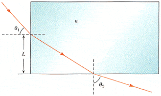

A light ray enters a rectangular block of plastic at an angle 1 = 44.0° and emerges at an angle 2 = 79.0°, as shown in Figure P22.61.
Figure P22.61
(a) Determine the index of refraction of the plastic.
wrong check mark
(b) If the light ray enters the plastic at a point L = 50.0 cm from the bottom edge, how long does it take the light ray to travel through the plastic?
ns
n1sin(1)=n2sin(2) or sin(critical)=n2/n1
i attempted arcsin(11/44) and arcsine(79/44) but both were wrong. Can someone please help me get on the right path?
Treat this as two refractions and apply Snell's law at each interface. Hint: How does the second angle (the angle of refraction) at the first interface relate to the first angle (angle of incidence) at the second interface?
I have sin(44)=nsin(theta2) and sin(79)=nsin(theta2) but that cannot be correct. I know that the angle of incidence and angle of refraction are equal. Please help I am mising something here.
Thanks
True, that cannot be correct, since [itex]\sin 44 \neq \sin 79[/itex].
They are related, but not equal.
For clarity, I'll rewrite the equations as:
[tex]\sin 44 = n \sin \theta_a[/tex]
[tex]\sin 79 = n \sin \theta_b[/tex]
Find the simple trignometric relationship between [itex]\theta_a[/itex] & [itex]\theta_b[/itex] by examining the diagram. Look for triangles.
