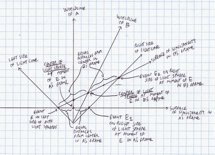

In the following reply I am going to make a strong distinction between the light cone and a light sphere; I will not use the two terms interchangeably. I am also going to make a strong distinction between the apex of the light cone and a center of a light sphere. The light cone is a single 4D geometric object in Minkowski spacetime which is the set of all events that are null separated (c²Δt²-Δx²-Δy²-Δz²=0) from the apex event. A light sphere is a 3D conic section of the light cone formed by the intersection of the light cone with any plane of simultaneity in any inertial reference frame, the center of a light sphere is the event which is equidistant from all of the events in the light sphere in the 3D plane of simultaneity used to form the light sphere.
cfrogue said:
OK, now the light sphere remains centered at O and also at O' in your diagram and O and O' are also diverging at vt.
Is this all correct?
Yes, that is correct the light sphere in O at any given t>0 is centered at x=0. Also, the light sphere in O' at any given t'>0 is centered at x'=0. Furthermore, the line formed by the centers of all of the light spheres in O' is given by the equation x'=0 or x=vt, and the line formed by the centers of all of the light spheres in O is given by the equation x=0 or x'=-vt'.
I am certain that you will think this is a contradiction, but it is not. The key thing to remember is that there is not just a single light sphere, there are in fact an infinite number of light spheres one corresponding to every coordinate time in every inertial reference frame. Different frames disagree on the location of the center of the various light spheres because each light sphere refers to a completely different set of events.
In contrast, there is a single light cone, and the apex of the light cone does not change. All frames agree which event is the apex (although they may disagree on the coordinates assigned to the apex if it is not located at the mutual origin) and that event does not change in any reference frame.
  • #161
cfrogue said:
Now, in the frame of O, t(L) = t(R) by the light postulate, t(x) means light strikes the point.
Yes, you can see this in the spacetime diagram. Note that L follows the line x=-1 and R follows the line x=1. You can easily see where each of those lines intersect the light cone and verify that both events occur at the line t=1.
cfrogue said:
In O', t'(L') = t'(R')
Yes, you can also see this in the spacetime diagram. L' follows the line x'=-1 and R' follows the line x'=1. Again, you can easily see where each of those lines intersect the light cone and verify that both events occur at the line t'=1.

  • #167
DaleSpam said:
In the following reply I am going to make a strong distinction between the light cone and a light sphere; I will not use the two terms interchangeably. I am also going to make a strong distinction between the apex of the light cone and a center of a light sphere. The light cone is a single 4D geometric object in Minkowski spacetime which is the set of all events that are null separated (c²Δt²-Δx²-Δy²-Δz²=0) from the apex event. A light sphere is a 3D conic section of the light cone formed by the intersection of the light cone with any plane of simultaneity in any inertial reference frame, the center of a light sphere is the event which is equidistant from all of the events in the light sphere in the 3D plane of simultaneity used to form the light sphere.Yes, that is correct the light sphere in O at any given t>0 is centered at x=0. Also, the light sphere in O' at any given t'>0 is centered at x'=0. Furthermore, the line formed by the centers of all of the light spheres in O' is given by the equation x'=0 or x=vt, and the line formed by the centers of all of the light spheres in O is given by the equation x=0 or x'=-vt'.
The fact is that the light sphere has two different centers based on any stationary observer.
That part is a contradiction.
However, I ran some simulations today and cannot get the light sphere in O' to exceed the origin of O if v = .5c on the negative x-axis side.
Do you also come up with this?
  • #168
DaleSpam said:
Yes, you can see this in the spacetime diagram. Note that L follows the line x=-1 and R follows the line x=1. You can easily see where each of those lines intersect the light cone and verify that both events occur at the line t=1. Yes, you can also see this in the spacetime diagram. L' follows the line x'=-1 and R' follows the line x'=1. Again, you can easily see where each of those lines intersect the light cone and verify that both events occur at the line t'=1.
My equations were wrong and I admit that for the particular situation given.
However, I am still looking at the origin of the light sphere located at two different places give the stationary observer.

The light sphere doesn't "move" in either frame, each frame sees that the sphere expands out symmetrically from that frame's origin and remains centered around that frame's origin.
Do you understand in each frame, the "light sphere" at any given moment is really the intersection between the light cone and a surface of simultaneity in that frame? And that since the two frames have different surfaces of simultaneity, they are not referring to the same set of points in spacetime when they talk about a "light sphere" at a given moment? For example, pick an event E on the left side of the light cone. Then in frame A, the light sphere at the moment of E would contain some event E1 on the right side of the light cone which is simultaneous with E in A's frame. But in frame B, that same event E1 would not be part of the light sphere at the moment of E, instead frame B would say that the light sphere at the moment of E contains some different event E2 on the right side of the light cone which is simultaneous with E in B's frame. So they are each talking about a different set of events when they refer to the "light sphere at the moment of E".
Any disagreement/confusion here?
