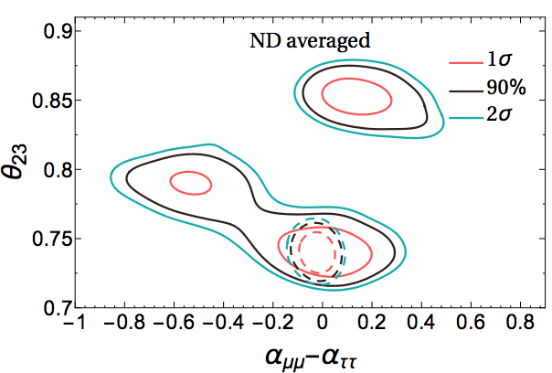

For a Gaussian approximation yes. As you noted yourself, this only gives an approximation that is valid close to the best fit. Let's take an example from one of my papers
Using the Fisher matrix method here would have been completely disastrous. So how was this plot constructed then? By discretising the ##\chi^2## function and evaluating it on a grid of points, like all contour plots in Matlab. The matrix he is talking about is the matrix of values of the ##\chi^2## function on that grid. Calling the parameters ##x## and ##y## and their grid point values ##x_i## and ##y_i##, respectively, the matrix elements are
\chi^2_{ij} = \chi^2(x_i,y_i).

If you want to do the full Bayesian analysis without assuming a normal distribution, yes, you have to do something like this. It involves marginalizing the likelihood function over all of the other parameters, which can be a computationally-intensive task. My impression of the OP was that they were looking for something far more basic.
If you have ##\chi^2(a_1,a_2,a_3)## and want to graph the likelihood contours in the ##a_1##, ##a_2## plane, then you have to marginalize over the remaining parameter via integration:
$$e^{-\chi^2(a_1,a_2) \over 2} \propto \int P(a_3)e^{-\chi^2(a_1,a_2,a_3) \over 2} da$$
Where ##P(a_3)## is the assumed prior probability for ##a_3##. Often this is taken to be uniform, though the choice of the parameter defines what "uniform" means.
For more parameters, it's generally necessary to use Markov Chain Monte Carlo methods, which are vastly more efficient in those cases. There are a great many analysis packages, such as CosmoMC, that provide nice utilities to do this sort of analysis, plus packages to plot contour graphs for the results.
