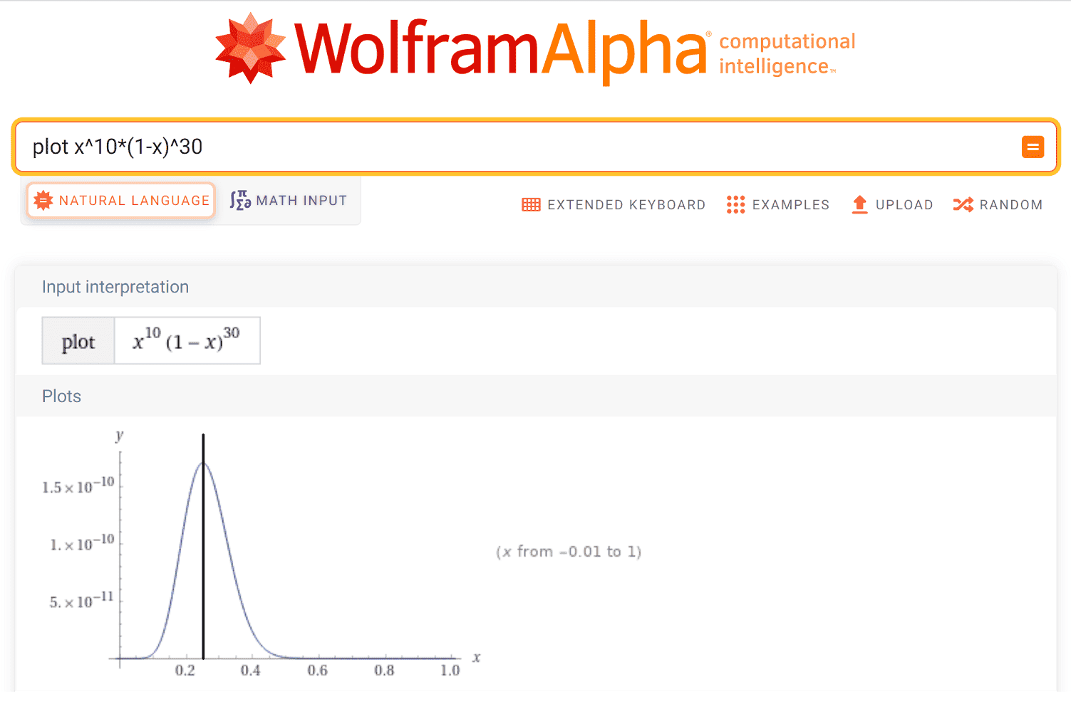

You're correct on everything; great job!
Here is a plot of the likelihood function for part (c), where $n=10$ and $\sum_{i}x_{i} = 40$. As you can see, it's maximized for $\theta=0.25$, as it should be from your derivation in part (b).
