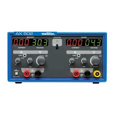

We see always in source meter machines a LED which indicates the limit current. I want to know what is the limit current and what is the relationship between this later and the resistivity.
What is a "source meter machine" ?
Likes chikou24i
Hi chikou24i. Could you explain what your "source meter machines" do? Can you provide us with a URL to a site showing one, so we can establish what it is.
Likes chikou24i

OK guys this is an exemple of sourcemeter unit : http://www.es-france.com/produit538/product_info.html , But what I want to know is what means CURRENT LIMIT physically.
On a power supply like you have shown, many have a current limiting adjustment
This can be set to limit the current from the power supply to a maximum output
This can save the circuit being powered from "burning up"
That is one purpose of a current limiting
Dave
I think they make it fairly clear in the pdf documentation referenced
http://www.es-france.com/pdf/AX501.pdf?osCsid=552b012b969105dbebe981f664fa19ae
that the supply has active current limiting via the "Current Limit" knob beneath the ammeter.
"Active current limiting" means that the regulator compares output current to a set value, set via that knob, and reduces voltage to whatever value will provide only that much current.. An LED indicates when the current limiter has activated.I didn't see mention of "resistivity" in the documentation.
Be aware that some supplies have a substantial capacitor right at the output terminals. If the current limiter controls current into that capacitor, then one could momentarily draw more than limit current from the supply while that capacitor discharges into the load.
