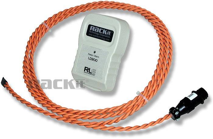

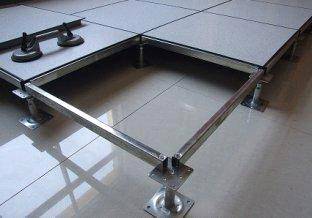

I actually installed something like this snake
around the perimeter, under a raised floor like this
It worked. I got a call-in from the maintenance guy informing me the alarm was sounding. He said, "be sure to bring your fishing pole as there are some Smallies under the floor.

Conductivity. Once "pure" water penetrates or contacts the concrete floor, it's not "pure" any more and will conduct nicely.
Fair enough, but what if the liquid that he wants to detect is alcohol or canola oil?
The unit dlgoff pictured is here:
http://rletech.com/product/ld300/
Ah, yes. And the first line under "Features" specifies "conductive fluid sensing cable". I repeat myself by saying, "What if the fluid that he wants to detect doesn't conduct?"

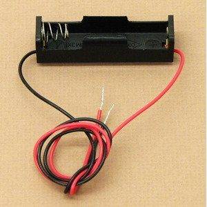

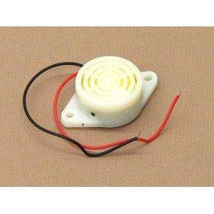

Thanks Danger! Say I buy a cheap buzzer off Amazon (with the two wires exposed, see picture below).
Would I need to add a battery to power it and create the buzz?

Yes. Pure water doesn't conduct electricity, but it almost always picks up conductive minerals when let loose. Given the items shown in your pictures, just attach the two red wires to each other, then tape or glue the two black ones very close together (maybe 0.5mm).
Also, smear some sort of grease around the contacts of the battery case just in case the water is conductive enough to short it out.
edit: And if you have a chance, sneak some salt into the water supply. :devil:
