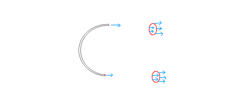

OK. Draw a free body diagram for the portion of the rubber tube representing half a circumference. Include the total force due to the motion of the fluid in this section of the tube as well as any other forces acting on this section of the tube.
In the attachment I have shown the left half of the tube.
The net force due to the fluid is towards left having magnitude 2ρAv2. Since it is in equilibrium an equal amount of force is exerted by right half of the rubber tube.
OK. Can you be more specific about the force exerted by the right half? At what point(s) of the left half does the force of the right half act?
The force on the left half is exerted on the circumference of two circular end points of the tube (in red). It's exaggerated view is shown towards right . The blue lines indicate the force on the circumference .The right half exerts force through the two end points .
OK. How would you relate the question "Find the force with which the rubber tube is stretched" to the force on a circular cross section (i.e., one of your blue forces in your figure)?
I am not entirely convinced but I will give a try
The force with which left half of the rubber tube is stretched = Sum of the forces on the two circular cross sections = 2(force on a circular cross section)
So, it comes down to interpreting the question. I tend to think that the question is asking for the "tension" force in the rubber tube created by the moving fluid. If you take a cross section of the tube, then the tension is the total force on the circumference of the tube at the cross section, as shown in your figure. If that's what the problem is asking for, then you should be able to get the answer easily from your free-body diagram.

Force on a circular cross section = 1/2(Force on the left half of the tube) = ρAv2 .

I would say that's right. But I think the force they want is the force on a circular cross section.
Is it correct ?
Yes. I think that's the answer to the question.

The curved portion of the U-tube may be considered a semicircle. In solving the U-tube question, you found the force that the fluid exerts on the curved, semicircular portion of the U-tube. So, this is also the force that the fluid exerts on a semicircle of the rubber tube. That was the purpose of relating the circular rubber tube question to the U-tube question.
Once you have the net force on a semicircular portion of the rubber tube, you can deduce the tension force at a cross section.
